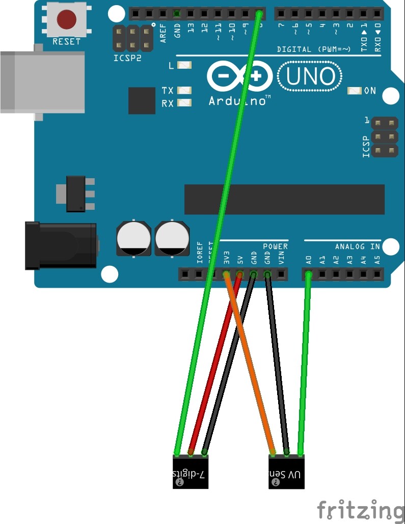

Hi There,
I'm relatively new to Arduino programmming and already have a nice project.
I want to read data from a adafruit guva-s12sd UV Sensor, calculate the energy in mW/cm2 and display it on a 7 digits serial display (Sparkfun).
Here's my error code. It says:
Arduino: 1.6.5 (Windows 7), Platine: "Arduino Duemilanove or Diecimila, ATmega328"
_20150909_Programm_UV-Sensor.ino: In function 'void loop()':
_20150909_Programm_UV-Sensor:25: error: 'disp' was not declared in this scope
_20150909_Programm_UV-Sensor:26: error: 'setDecimals' was not declared in this scope
_20150909_Programm_UV-Sensor:28: error: expected ';' before '}' token

In the attachment, you will find the wiring. What I am doing wrong?
Best regards,
Robert
SoftwareSerial disp(softwareRx, softwareTx);
This is a local variable. It goes out of scope at the end of setup(). Move it before setup() to make it global, so it can be accessed in loop().
