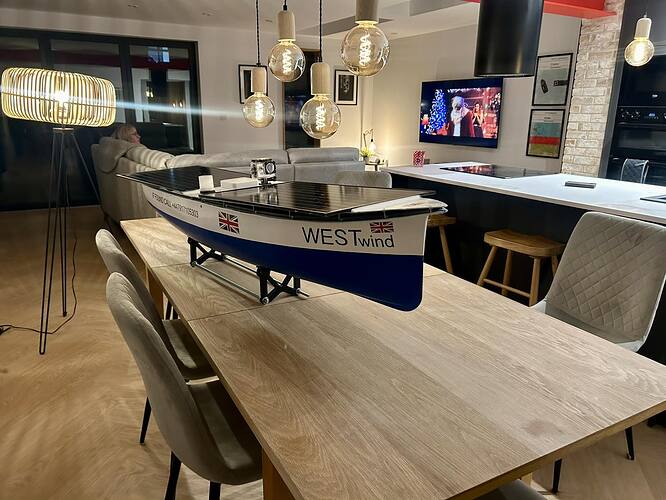

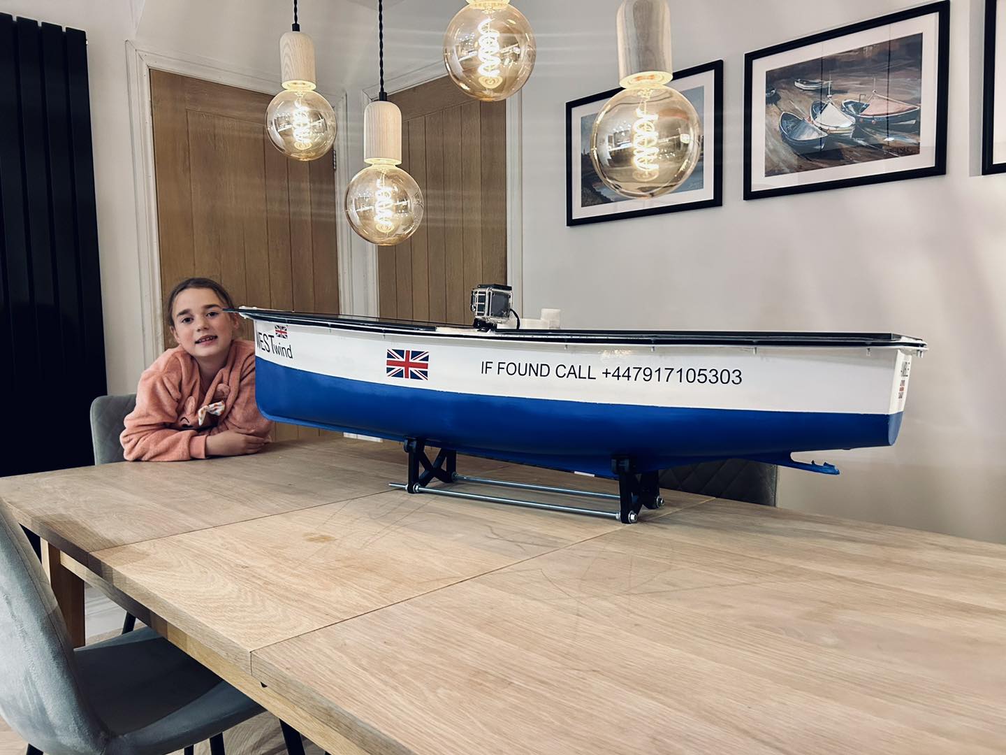

Hello everyone. I thought it would be good to share with you all a project which me and my 9yo daughter and busy with.
The project involves building a small boat and have it sail autonomously from the north east UK coat (Northumberland) to Norway. The project is around 90% complete and we are currently doing some rigorous testing in local waters to test its performance and reliability.
The hull is based on an RC hull and has been adapted to our requirements. The boat in its entirety has the following specs:-
2x 23ah 12v batteries
2x 30w solar panels up top
40a esc
1000k brushless motor
35kg servo for steering rudder
Arduino UNO 1 is for navigation
Arduino UNO 2 is for communication
Rockblock 9603 for communication
plus various other sensors to implement some navigation / power control.

The boat is now finished although there is still some testing to do with the boat in the new year namely with the navigation code and how i make the program more robust
Here are a few photos of the finished boat. Head over to our Facebook page 'Project West Wind' for some more build photos
