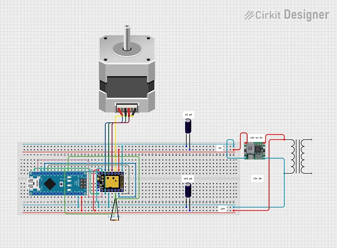

The 17HS4401 motor and TMC2209(has heat sink) driver are running very hot(it's painful when you touch the motor). I have set the vref and measured it (1.79v)
So as i read 60(Celsius) is normal, maybe a bit above? Otherwise, the motor runs really quietly.
I am trying to make rail for precise macro photography on my own, but first i need to clear almost every unknown of how to set up the motor properly with the TMCStepper library and use of AccelStepper library, so i can move the motor a couple of micro meters at a time!
My questions are do i utilize properly software serial connection that configures the driver with via the TMCStepper library? I wired one digital pin on my arduino nano to the CLK pin of the driver to act as software TX and then bridged another digital port with 1K resistor to the same CLK pin. For directions i looked here Stepper_motor_developing_platform and janelia-arduino/TMC2209
Both of them show that method of communication with one wire, but i am a bit confused on where should i use it? USART or CLK? In one other example i saw that hey use software slave clock (SCK), should i use it here and with what pin? And what type - hardware or software serial on the nano?
To be clear the motor runs fine i just wonder if those driver configurations are doing anything or if i am doing something wrong!
EN - 12
MS1 - 11
MS2 - 10
PDN - GND
USART - not connected
CLK - 2
STEP - 9
DIR - 8

Software serial will not run anywhere close to the speed you are trying to use.
11520 is a strange baud rate:
...for:
https://docs.arduino.cc/learn/built-in-libraries/software-serial/
Maybe it isn't communicating anything at all. When you tell it go 1000 1/32 microsteps forward (56° ?) and 1000 1/16 microsteps backwards, (112°?) does it end up in the same place or move 56° (?) per cycle?
Try less current by using a smaller Vref ( 1.2V? 0.9V? whatever) and see if it moves well.
