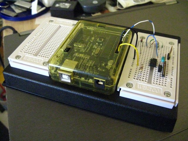

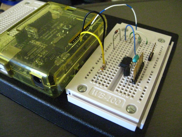

I made this protoboard platform. It makes staging experiments easier.
There's lots of real estate inside the project box (Serpac 071BK).
I'll get around to placing some screw terminals and so on, lots of room still on the exterior surfaces.

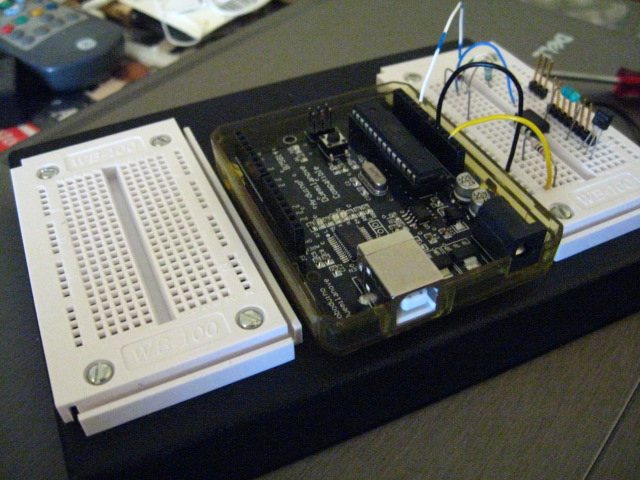

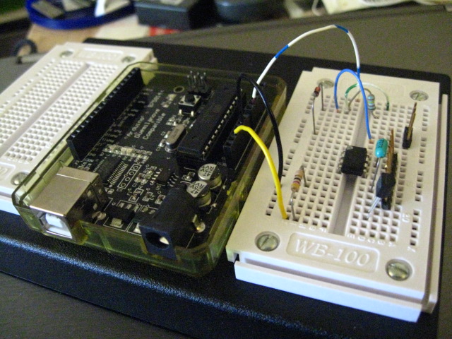

I used the Arduino box to hold the Arduino because I don't like the Arduino's 3-hole mounting. It snaps smartly into the box.
I took pics with and without the top panel (lid). Things are more accessible without.

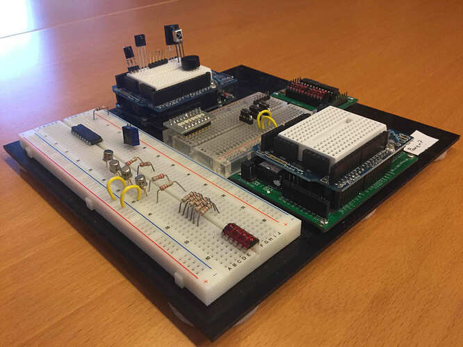

I made this front panel to a breadboard setup a while back.
Might want to consider a removable version attached to the back/front surface of your mounting box.
