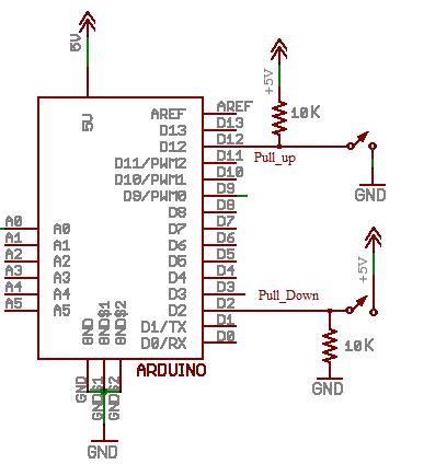

Eventually I created this simple wiring below (using 10K resistor), and used the provided Example "Button" sketch, but modified it to not use the built in pullup resistor .
Pictures:
When I hold the button down, the resistor gets VERY hot. When I put a volt meter between the resistor and ground, I see the volts go up to 5v and amps at .3 when the button is closed.
If I understand wattage correctly, that's 5 x 0.3 = 1.5 watts. My resistors are the ones that comes with the ELEGOO Mega Starter Kit, so I don't know the watt rating.
So is my solution to buy 2 watt resistors? Or can use multiple ones in parallel?
Or would just a higher rated resistor work (like 1M)?
I just see so many examples using 10k, I'm surprised mine got burnt up like this.

Use your meter to measure the resistance of your resistor.
That resistor should have a red band or orange band on it depending on if it is a 4 or 5 band colour code.
5V across 10k == 5 / 10000 = 0.5 mA.
Power dissipated P = V x I = 5 x 0.0005 = 0.0025 Watts
Your resistor;
5V 0.3 A == R = V / I = 5 /0 .3 = 16R. nearest prefered value 15R
15R brown/green/black
Besides it seems to me that this resistor is not 10K (Maybe 10 or 1 Ohms), it seems that what is connected as pull_down and not as pull_up.

First, YES, it looks like I was using 10 and not 10K resistors! Wow, sorry I missed that one.
Second, for some reason I thought I read that the UNO R4 WIFI did not have built-in pullup resistors. I guess they do.
Ok, good to know. Thank you all!!
