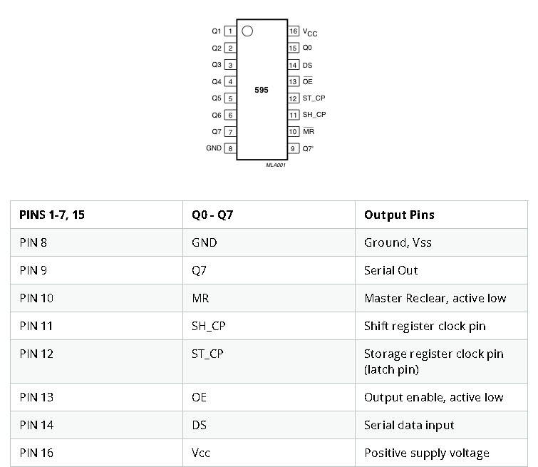

For the shift registers..i have found one example working for me perfect..
(examples/control surface/arduino helpers/hardware/extended input & output/In & out/ TOGGLE LEDS.ino)
So..in this example for arduino uno:
    • SS: 74HC595 ST_CP--- pin10 (SS in arduino uno) /// pin 53 (SS in arduino MEGA)
    • MOSI: 74HC595 DS--- pin11(MOSI in arduino uno) /// PIN 51(mosi in arduino mega)
    • SCK: 74HC595 SH_CP--- pin13(SCK in arduino uno)////pin 52 (sck in arduino mega)
      Then.. follow this picture for connections on cd74hc595
      Sin-t-tulohh
With this information..no problem following the example..
I will prefer reading cc for switch on or off leds but hey..this its good for me by now
