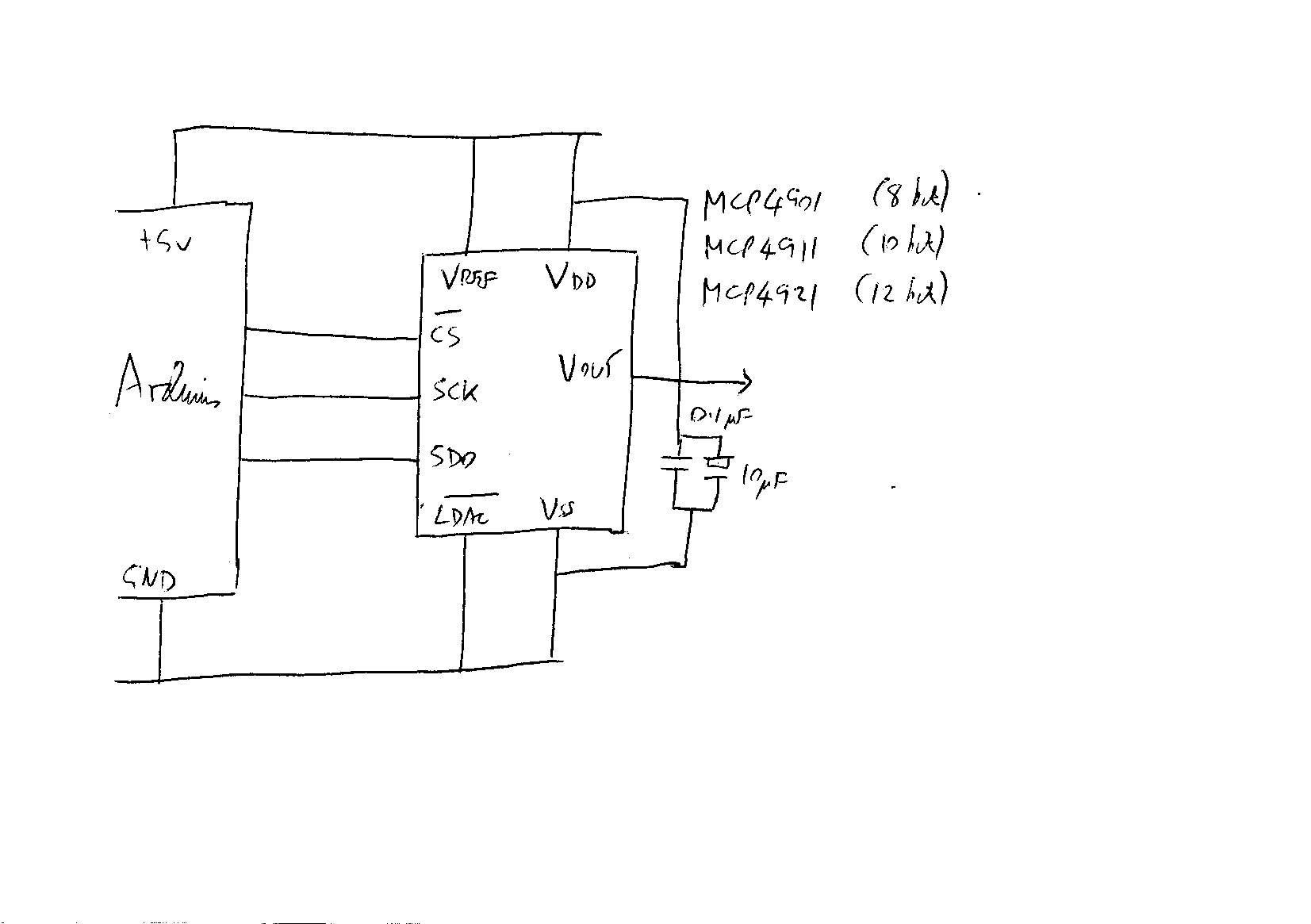

As an aside, why go to the complication of building a 2-pole filter using an op amp and a pile of discrete components, when using a D to A chip would be much simpler?

I have not connected a DAC chip to the Arduino - is there an example you could refer me to?

Connecting an SPI DAC chip to the Arduino is very simple, see attached schematic. You need 3 pins configured as digital outputs.
Ah - very easy indeed !
How would the sketch look like?
The only problem is then that I have uploaded the LabView toolkit for Arduino onto the UNO and presumbly I would need to add that code to the LabView sketch?

The code would be something like this:

OK - looks simple, many thanks again.
