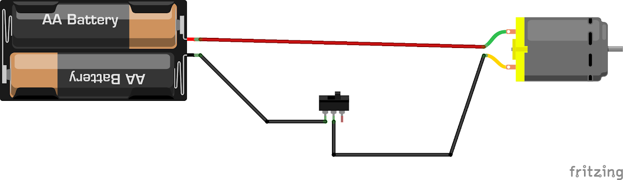

The H-Bridge is part of a larger project, this being just a small part I had to include. Right now for testing just the H-Bridge I'm using an Arduino Uno, but eventually for the whole project I'm going to use an Arduino Mega. I attached a schematic for the H-Bridge, but it's not a very good one :sweat_smile:.
Can this work?
imagine you have control 0 and 1 at low level. U6 and U8 would be conducting current in both directions, considering their flyback diode. If your motor is spinning then U6 and U8 would act as a brake.
This circuit may be fine for turning the motor on and of now and then, but for speed control with PWM, I assume you need to drive the 4 mosfets individually.
The SI2369DS is a P-Channel MOSFET, yet you show it as a P and N channel.
Is you schematic correct?

Bad design with massive shoot-through, that can kill the mosfets.
You should drive the four mosfets separately, with the required dead-time.

Ok, this H-Bridge is just a small part of a larger project. It's meant to control a small DC motor, 5V and the current is less than an amp. The schematic is more of a concept idea, the MOSFET's I actually use are IRFZ44N for NMOS, and SQP100P06 for PMOS. I understand the concept of using 4 signals/pins to control the motor, however after talking with certain people I was led to understand that it is possible to control the H-Bridge with just two PWM signals, for both speed and direction. I tested this circuit on a breadboard and the motor does run without large problems, even for a longer period. Also when testing the motor the two signals are opposite, when one is HIGH the other is LOW. What I really want is to know if this approach with two PWM signals is possible and how exactly should I generate these two signals.
If the 2 signals are opposite, that you offer to control0 and control1, what you are doing is running the motor in opposite directions at every PWM cycle.
If your PWM dutycycle is less than 50% one turningdirection will win the armwrestling contest and if it is over 50% the other direction will win.
The further away from the 50% duty cycle the faster it will spin.
Not sure if that is what those "certain people" had in mind, but ignoring the disadvantages of running and braking a motor at the (almost) same time and the shoot-through issue (when both fets are partly on, giving some short circuit during switchover), I would say it is possible.
Would I do it this way? Never.
Well, commonly used motor driver ic's like LM298D uses 2 pin interfaces and work just fine with simple motor control. Limited gpio usage is mostly a positive thing.
Futhermore, I think there has been a misunderstanding on how the circuit will function. Instead of the "more powerful wins" sceneraio, my design incorporates cw and ccw drive pins and whichever gets power, in the condition that other doesn't get any, the mosfets at top right and bottom left will enable, either by pwm or full power, making the motor have a current flowig from right to left, and the opposite for the other control wire. this will make all the mosfets same channel type make it easier to understand (arguably) along with saving 2 pins to be used at a later stage of the circuitry
