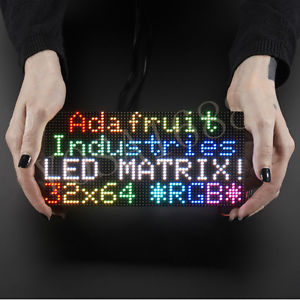

There is another type which is cheaper. They come in 16x32, 32x32 and 32x64. These are the type Mike was describing, where the Arduino must perform the multiplexing, dimming and colour mixing. An ordinary Arduino such as Uno is only just powerful enough to run these displays, in a limited way. There may be not much program space and speed left for your application. These displays are not really suitable for beginners. Unfortunately, this is the type used in the guide you gave the link to.

So, should I go for an Arduino mega?
Found this!
https://goo.gl/aqk39A
Perhaps Mega. It has more ram and flash memory than Uno/Nano/Micro. But it is the same speed, so you may still be limited in the number of colours available, if you follow that guide.
The ws2812b matrix does not need so much speed. But again, if using an Uno/Nano, most of the ram memory will be used, leaving very little for your programs. And the guide you linked to may not help you very much because it does not use that type of matrix.
If you want more speed and more memory, you will need to look at something more exotic, such as a Teensy 3.x or an esp8266. But again, this may not be simple enough for a beginner.
