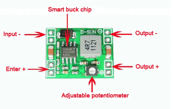

Thank you so much for your advice. I cannot find quick way of getting this particular part but I guess there are alternatives. E.g. I found a part I can get my hands on Monday
Buck
Input 4.5-28V**
Output 0.8-20V**
Output current up to 3A
I guess this one will do as well.
The ones with the adjustable output can be difficult to set and sometimes are not stable.
Also a 3A regulator may not be very efficient at only 140mA.
See if you can find one with a 3.3V fixed output and with a current rating of between 250ma and 1A
