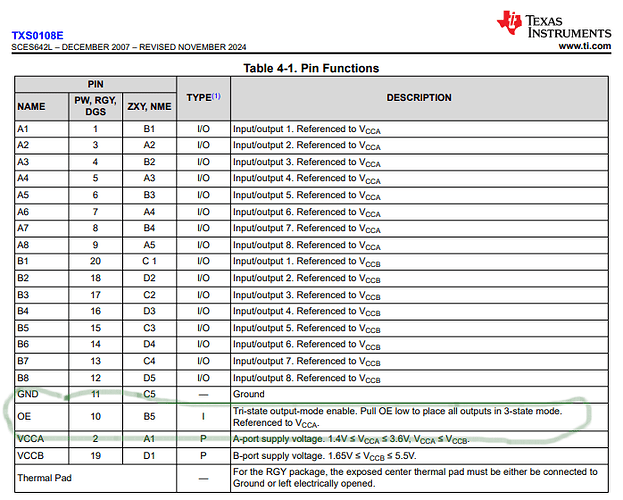

The board is wired wrong. The two grounds need to be connected, the OE pin should go to the Ground.
Here is the corrected board wiring
Umm, if that's a TXS0108E on that breakout, it appears to me that the datasheet says otherwise...
