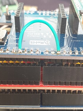

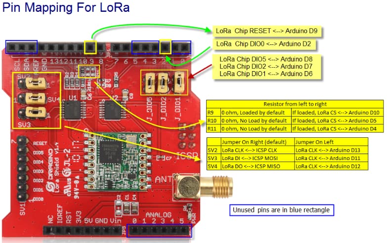

I have the following challenge to overcome, where I don't know the correct solution for it.
The hardware are two Arduino uno's that is used as Client and Server both have a Dragino Lora shield attached to it. The communication from server to client and from client to server is working
Only on the server side there is also a click shield(MIKROE) attached to it that works on SPI that works fine with the sample code from MikroE if the Lora shield is detached.
I know that it is not possible to use the same output for chip select on SPI.
So I used Pin 10 for Lora Shield and Pin 4 for the Click Shield to convert the distance to 4-20mA
In my believe the Library from Radiohead that is used for the lora shield
should deactivate chip select pin. after it is used by it.
This is my code that I use.

What am I doing wrong because it is not sending to the Click board(4-20mA T Click).
I can not control the Click Board 4-20mA to send the mili amperage.
