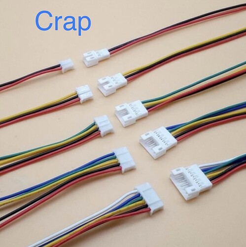

Rant, these Per-made Cables are Crap
Micro JST PH 2.0 2P 3P 4P 5P 6PIN Male Female Plug Connector With Wire Cables
_________________________________________________________________________
I’ve seen these inexpensive cables on eBay for a while.
Bit the bullet and ordered one of each size.
At first glance, these looked reasonable.
After using them in several projects, the vote is in; these are the worst quality wire cabling I’ve ever used! (in 50 years) !
There is no problem with the crimp connection, the problem is with the cheap wire strands used in the wires.
A few flexes of the end of the wire where soldered to your PCB or a few more flexes of the wire somewhere along the wire length, the wire strands break.
The copper used in the strands is too brittle and end up breaking.
( Maybe aluminum with tin plating :angry: )

Larry’s new law #101, only use silicone insulated wires, always make up your own cabling with connectors !
  • #28AWG has 16 strands of 40 gauge tinned wires
  • #26AWG has 30 strands of 40 gauge tinned wires
  • #24AWG has 40 strands of 40 gauge tinned wires
  • #14AWG has 400 strands of 40 gauge tinned wires
FYI

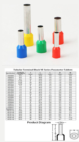

Maybe ferrules help, at least where the problem in the solder connection to the PCB because these have a chance of spreading the strain between the conductor and the insulation. https://www.arrow.com/en/research-and-events/articles/what-are-ferrules-and-why-should-you-use-them. If the wire is prone to break through fatigue at mid length, however, nothing much can be done.

Odd, I just received some VE0508
But that means you’ll never be able to make off a cable again without it breaking
Interesting. I was wondering if, after crimping, the shape was regular enough to fit in a reasonably sized PCB hole (without having to be wildly oversized, that is). I have not actually used these myself in this application.
Ferrules are probably not an application for PCB pad soldering; I got mine for terminal strips.

I will say soldering silicone insulated wires as I do, i.e. 28AWG/26AWG (16/30 strands), have never broken at the solder point or anywhere else.
If I need a Dupont/JST disconnect, I’ll forget about commercial pre-made cabling and DIY !
The wire is copper, it's just thin, probably of low quality - the stuff that goes into the ends and premade cables is typically worse than normal made in china wire, which is worse than domestic wire. Utter garbage.
The silicone insulated pre-crimped jumpers I've got were still like 4 AWG undersize. They all are. FEP wire does seem to be on target, for whatever reason (maybe the more difficult processing keeps out the riffraff?). I've gotten wire that was 8AWG undersize in PVC-insulated cable ends like that. They're crap. The dupont line, the problem is often the terminals (though some of the wire is horrible too - the ribbon cable is trash, as is anything that's magnetic, the best you can do on pre-crimped dupont starting from 1P jumpers or from individual wires (not ribbon cable) with terminals at the ends. There are 2 or 3 kinds of chinese knockoffs of harwin's original crap knockoff of DuPont's connector. The best kind of knockoff terminal, made in tin and gold surface treatment (when buying terminals, if you only buy the gold flash ones, you'll get these) is not much worse than Harwin's, though that connector attracted a lot of the same criticism as modern dupont connectors. The other two are horrible though, You can unfold them and flatten them into the flat sheet metal they were made from, and see the exact same pattern, just with slightly different dimensions, (particularly, shorter crimp area), and measure the thickness of the metal and see that the good ones are thicker. The worst of them is the type found on the ribbon cable. They have hair-thin wire, and ribbon cable dupont line always fails pull test.
Now, the wire breaking off when soldered straight to the board is NOT their fault. That is your fault - the very next thing you do after soldering on a wire to a pin is to glue it down with hotmelt glue or other fast-set adhesives. The solder wicks up the wire, then solidifies. Now there is a rigid structure making up the wire for a short distance, then an abrupt change to fully flexible; that is a stress point and the wire will fatigue and break shockingly fast. (also often complicated by the fact that part of the problem may be a weak solder joint (which you might add flux to and fix up once it was glued down and held in place by the glue so you don't need 3 hands), but the long wire, particularly once solder wicks up it, acts as a lever to more easily break the joint. (In tricky reqork cases, i someyimes alternately solder and glue, because ive broken off on wire in a cable being soldered to board while doing the others.

After examining the wire strands under a microscope and doing some flex testing the wires are copper but have to conclude the copper strands is very poor quality.
The silicone wire discussed above with the 40AWG strands, i.e. huge number of strands, is simply the best :+1: .

Under magnification X70, I used a new scalpel and slowly scraped thru wire strands.
There was no silver/aluminum colour visible in doing this; meaning aluminum with electroplated copper was unlikely ?
After multiple wires that had a breaking issue, only copper scrapings were seen.
From this I concluded the strands must be solid copper.
However, there might be a possibility the strands are a poor alloy :thinking: .
BTW I measured silicone insulated wire strands in 28AWG wire (made from 16 strands of 40 gauge), they all were around .003".
