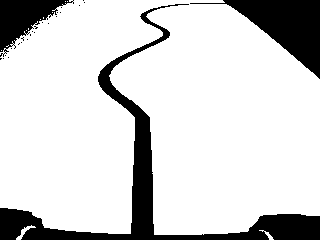

Since I want to use camera for high speed autonomous robot control (Arduebot) I need high fps pictures sent to Due (the other Arduinos are no options because of lack of horse power). Pictures will be simple b&w, no high resolution is needed (80x60 or even 40x30 might be OK). Camera will be mounted sloped and take pictures from front of Arduebot (the "present") until a little ahead (in order to capture the "near future"):

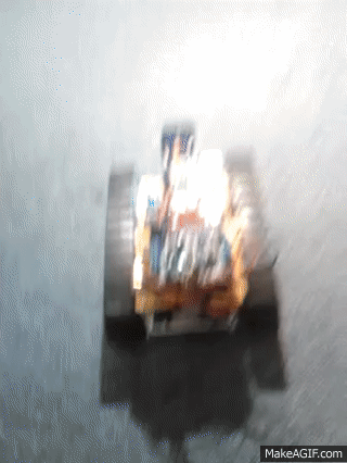

90fps video taken from on robot Raspberry camera, so what you see is slowed down by factor 90/25=3.6:

automatic camera tilt calibration using Raspberry camera
"Howto capture 360fps (640x240) videos with Raspberry v1 camera"
https://www.raspberrypi.org/forums/viewtopic.php?f=43&t=199204&p=1242609#p1242609
(the animated .gif is slowed down by factor of 25)
"I hereby confirm that my finger that I moved quickly before the Pi Zero is NOT transparent" :lol:
The Raspberry Pi Zero can be bought for 5$ with 5$ shipping.
The v1 Raspberry camera can be bought for 5$ with free shipping on aliexpress.com
Will connect the Pi Zero with Arduino Due mounted on back of caterpillar robot for camera feedback PID controller on Due soon ...
... in order to get caterpillar robot do high speed U-turns under camera PID control:
Hermann.
