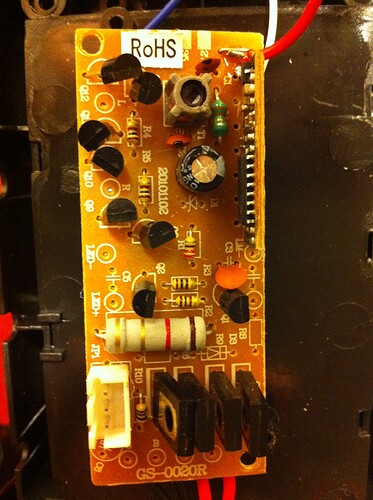

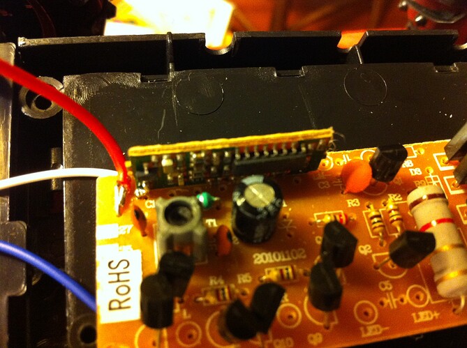

Step 1: Open up the RC car and locate the motor control circuit board. As I understand it, the RC receiver will take radio control signals and pass them to the appropriate input pins on the motor controller. I can remove the RC receiver (unless I want to keep it for fun). I then need to connect the Arduino to the controller.
Questions:
a. Is this correct?
b. Can I use the motor control board that comes with the car, or do I need to purchase an Arduino motor shield?
c. Do I need to worry about voltages/currents between the Arduino and the control board?
d. What kind of hardware do I need for all of this (breadboards, wires, resistors, connectors, etc.), and why?
