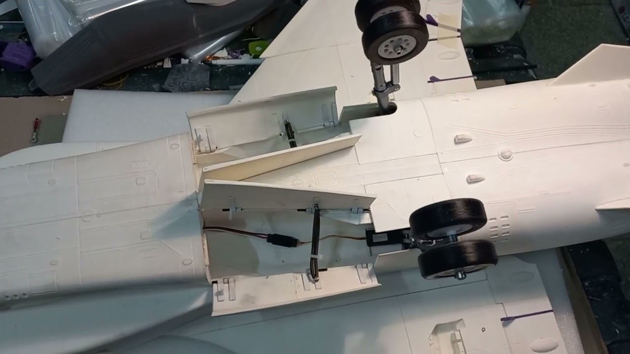

So id like landing gear and its door to extend/open and Ive tought of using 180 degre servos for the job, something like this:

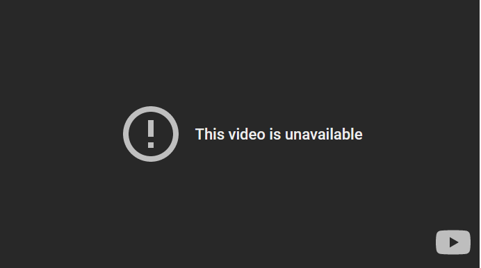

Your second video is not viewable...

Have a look at some RC projects - mechanically the doors are often linked to the undercarriage links so one servo can open the doors and drop the legs .
The linkage needs to go “ over centre “ as a servo with not support the landing forces trying to close the under carriage .
You can buy pneumatic legs that can work off a single servo
