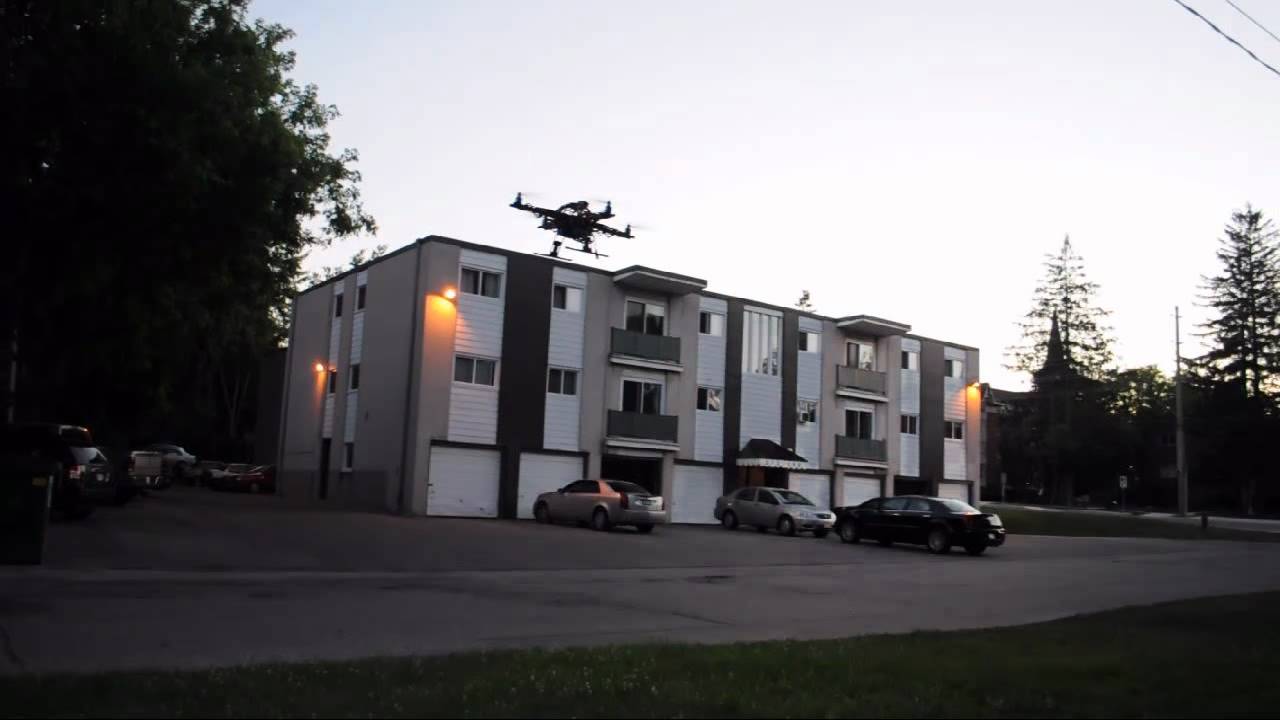

I'm thinking a more open area would have been better for a first flight.
Sun setting, Instructables contest deadline in a few hours
$15 frame, whatever, I have a spare frame if I have to put it together, but I'll probably invest in an aluminum frame later
As long as you had a plan …
Did you break many props? Hard to tell from the video. Would have been really exciting hitting the power lines 8)
I'm doing a project that is almost the same as yours, diverging that I'm gonna use XBee as the transmitter. Now I'm really scared, cause everyone I see using this frame ends in tragedy in the first flight.
Look, was the stabilization system working well? Just accelerating up is not enough to a smooth take off?
I broke 2 props in the final crash, I buy them 8 at a time so I have spares.
As you can see, most of the time the gyros kept the helicopter really REALLY level, it was mainly wind and inexperience that caused the most troubles.
The accidents you saw are mostly due to hitting the tree, if you look closely, even after that really wild takeoff, it recovered almost immediately.
Don't be afraid! My frame cost only $15 (I think it's economical because a single stick of aluminum from Home Depot costs around $10 anyways), I got two sets so I can rebuild within a day or two if I wanted to. Get a better frame if you want.
