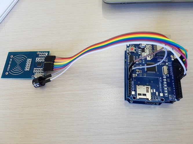

I am building an rfid system at work. The system is working with arduino uno and RC522 (with a buzzer on pin 7) but things got mixed up when trying to add ethernet shield to communicate via ethernet. I am new to the ethernet shield but I learned that i cant use the pin 10 on the shield. So i changed the SDA My pinout is like this:
Pin Pin
Arduino Uno MFRC522 board
9 RST (Reset)
8 SDA (SPI SS)
11 MOSI (SPI MOSI)
12 MISO (SPI MISO)
13 SCK (SPI SCK)
And the code i use is at the end. So my question is will this pin layout work? If not what do i have to do?
Also it would be nice, if you can post guides / helps about using the shield. I need to read the same data on the serial monitor via ethernet.
I have also attached the photos of the pins.
