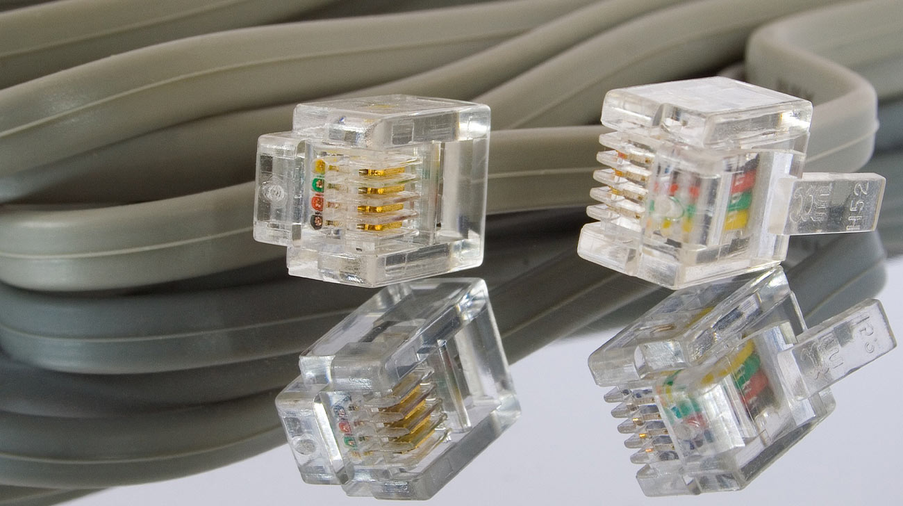

I'm running a 15m cable from the GPIO of the arduino to the camera I'm controlling. Sticking the wires on to the bread board clearly won't cut it. Any suggestion on what would be a good connector to use so I can plug and unplug the GPIO cable from the case that I put the arduino in? The most obvious one would be RCA connectors. But I wonder if I'm overlooking better alternatives. (I also considered whacky choice like use an RJ11 jack, or molex cable-to-cable connector, etc).

  • RJ11 connectors might work.
