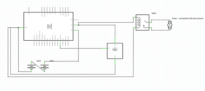

Here is my diagram:

Wrt your schematic the powersupply for the motor is missing.

The relay that you use has 3 connection : GND, PWD, SIG!
On power fase 3 connection : NO, C, NC
To activate it you need to connect SIG to a DPin of your arduino. Change the state on DPin (example D8) the relay switch the state C->NO (D8 LOW), C->NC (D8 HIGH).
You do not have this connection on your schema

The way the relay is wired, image from post#5 the relay is on all the time.
An example of a way to control the relay as depicted in post#5 to operate from an MCU.
