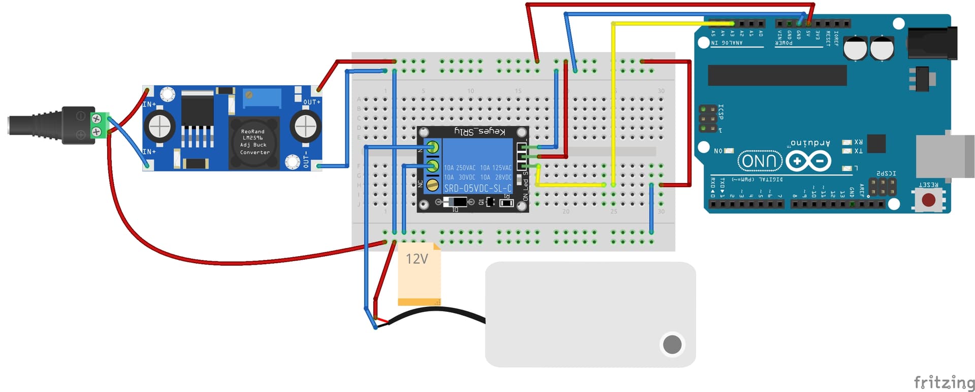

My Wiring

The pump would like to have a free-wheeling-diode to kill the induction voltage caused by switching on to off.
Hi, @swerve0322
Move your gnd/neg wire for the pump, back to the 12V connector.
At the moment you have pump current flowing through the gnd that is shared with the UNO.
Moving it to where I have edited, makes sure the pump current is not flowing through any wiring associated with the controller.
The diode will help against Back EMF from the pump motor.
Make sure it is connected the correct way around.

The diode on the relay module is for the coil in the relay, it has a similar back-emf when it is de-activated and can cause mischief.
You will find all relay modules like yours will have them fitted to each relay.
That circuit you have shown, does not have the pump supply as part of the controller supply, so interaction would be minimal, but even here a diode across the pump is advisable.
