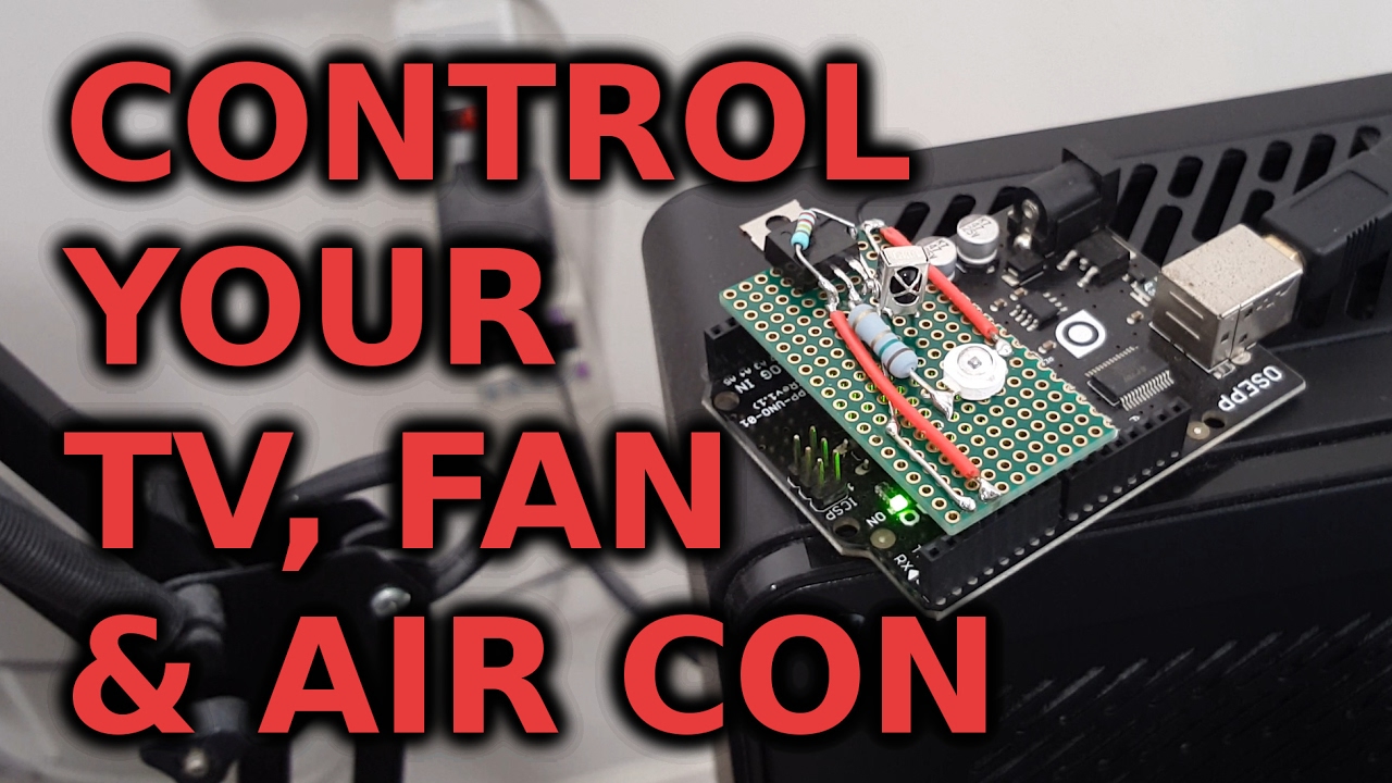

No problem. I'll do it for you:
6v6gt:
https://www.youtube.com/watch?v=kmf8ZfWdGU4&t=74s
thanks <3
i found an easier one which says i need an arduino, ir receiver, and the ir led and thats it which seems too easy. so why the other ones are so advanced?

Here is the source code from this link
#include <IRremote.h>
IRrecv receiver(2); // receiver is connected to pin2
IRsend sender;
decode_results results;
long repetitions;
long count;
unsigned int durations[100];
void (*reset)(void) = 0;
	receiver.enableIRIn(); // start receiving signals
	// check for text from the PC
	// the PC sends a string containing "r,n,a,b,c,d,e,..." where r is how many times to repeat the command,
	// n is the number of durations, and a/b/c/d/e/... are the durations.
	// the durations are how long each mark and space period of an infrared command should last, in microseconds.
	if(Serial.available()) {
		// parse the text
		repetitions = Serial.parseInt();
		count = Serial.parseInt();
		for(int i = 0; i < count; i++)
		durations[i] = Serial.parseInt();
		// send the command using 40kHz PWM
		for(int i = 0; i < repetitions; i++) {
			sender.sendRaw(durations, count, 40);
			delay(50);
		// for a bit of fault tolerance, reset the arduino after receiving any command
		reset();
	// check if a decoded infrared signal is available
	if(receiver.decode(&results)) {
		Serial.println(results.value, HEX);
		Serial.print(results.rawlen - 1);
		for(int i = 1; i < results.rawlen; i++) {
			unsigned int number = results.rawbuf[i] * USECPERTICK;
			Serial.print(",");
			Serial.print(number);
		Serial.println("");
		receiver.resume();
