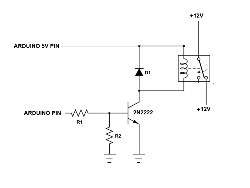

I would like to ask, is it possible to keep everything but just replace the relay with a P-channel Mosfet?
Attached (Relay.jpg) is my current schematic. The relay will disconnect the 12V wire to cut the power.
Thanks. :slight_smile:

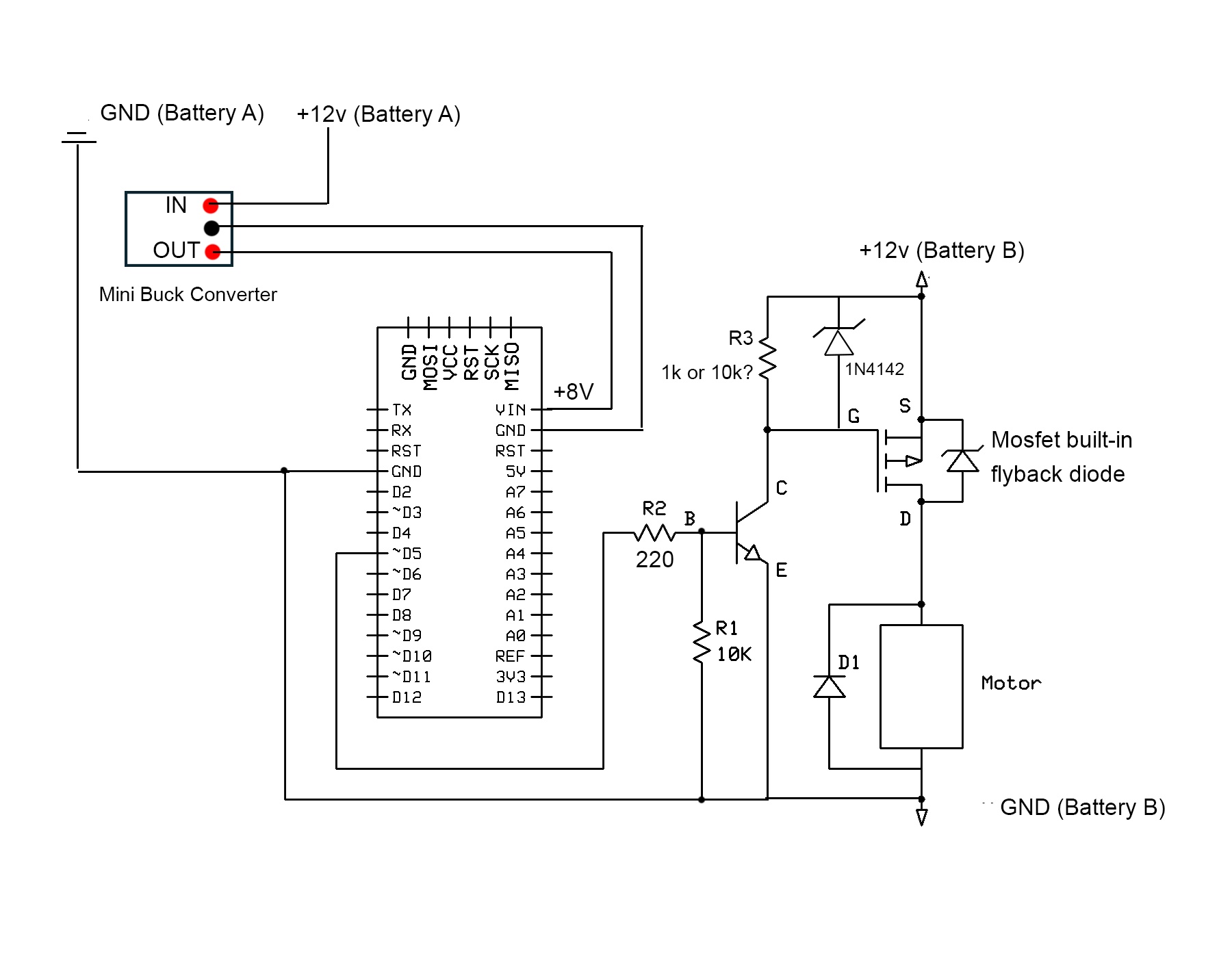

This is the schematic that fried my mosfet.... any idea?
Good news:
I got an opto-coupler now... haha...Will give it a try. But before that, can let me know if this is correct?? and where should i ground the opto-coupler? +12v ground? or can share the same ground as arduino??? :slight_smile:
Thanks
Steve
Can you post a picture of your project so we can see your component layout?
This is a better schematic, pointing out the connection required between gnd of Arduino and motor supply.
Not knowing enough about the motor circuit you may not be able to do this.
Tom.. :slight_smile:
This would be better, back EMF diode
A schematic is clearer and more informative if you show the full circuit.
Tom... :slight_smile:
Where did the 10k in the BJT emitter come from? Which MOSFET are you using?
If you want to reduce the chance of frying your MOSFETs add a zener between gate and source.
Over voltage on the gate will always instantly destroy MOSFETs, you have to ensure this never
happens, either when handling the device, or in circuit, and a 12V zener is a great way to do this.
You still need a resistor between gate and source to turn the device off.
If the grounds were not commoned that would explain why you were destroying the MOSFETs - one circuit
attached to the gate, the other to the source, its a tug of war...
steve_1988:
Because the 10k resistor mistakenly put there prevented the FET from actually turning on fully.
If not turned on fully, it will dissipate more power than the motor and of course burn out.
And without the diode across the pump it may burn out anyway from voltage spikes... Schematic in #9 does things right.

Opps. Just realized that I put the 10k at the wrong place in the picture. It's a pull down resistor for Base. This is the MOSFET that I'm using.
This is the latest schematic and am going to try this tonight.
I'm wondering whether the emitter should connect to Arduino ground??
Mini buck converter that im using
Thanks
Steve
You will need to connect the gnds of both batteries together with the Nano gnd.

After more research, I think my previous schematic has a problem... For P-channel Mosfet, it should always pull-up right? If yes, do i still need to have the pull-down at transistor base? will it cause "floating" issue??
You don't need the 10K at the base of the BJT, is low impedance and won't float like a MOSFET gate will.
You can leave it in, 10K will not be a problem.
The 10K between the gate and source of the P-CH MOSFET is essential.
With P-CH MOSFET the gate has to go NEGATIVE with respect to the Source to make it conduct, that is what the transistor does to the MOSFET gate.
Do you have to switch the positive of the motor, that is High Side switch?
It would be easier and lower component count if you switched the gnd side, or LOW SIDE switch with N-CH MOSFET.
Haven't you tried the circuit yet?
