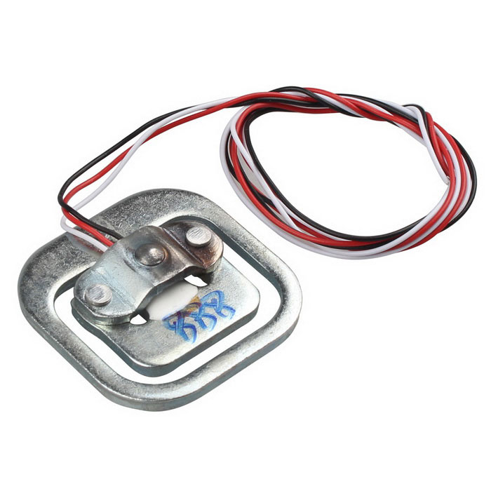

Hello, i have load cell and the amplifier... i ever try so many, learn in the internet, use library code, try change the sensor, try change the arduino.. but the sensor did'nt work, would you want to help me to solve this problem???
I use load cell like the attacched file

These are the load cells I have got. Haven't tried them yet but mine will be configured as a Wheatstone Bridge to weigh a Bee Hive

Doesn't work like that. The HX711 needs a Wheatstone bridge.
Add a second load cell to the A+ input with red and black wires swapped, for a full bridge.
Or add a voltage divider with two equal (1k) resistors to the A+ input.
Google something like "load cell half bridge" for diagrams.

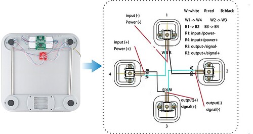

Actually i want to use 4 load cell sensor,, like this image
So, how about the wiring??

Did you measure the resistance of the load cell before connecting them.
The colours with the highest resistance connect to E+ and E- (excitation voltage).
It is NOT always red and black.
If the half bridge is done right, there should be less than 10mV between A+ and A- without weight.

This is how you connect up those sensors to the HX711 in a Wheastone Bridge configuration. These diagrams I downloaded form the ebay seller so haven't confirmed whether it will work or not
Have you tried this? no need resistors to get the output correctly?
