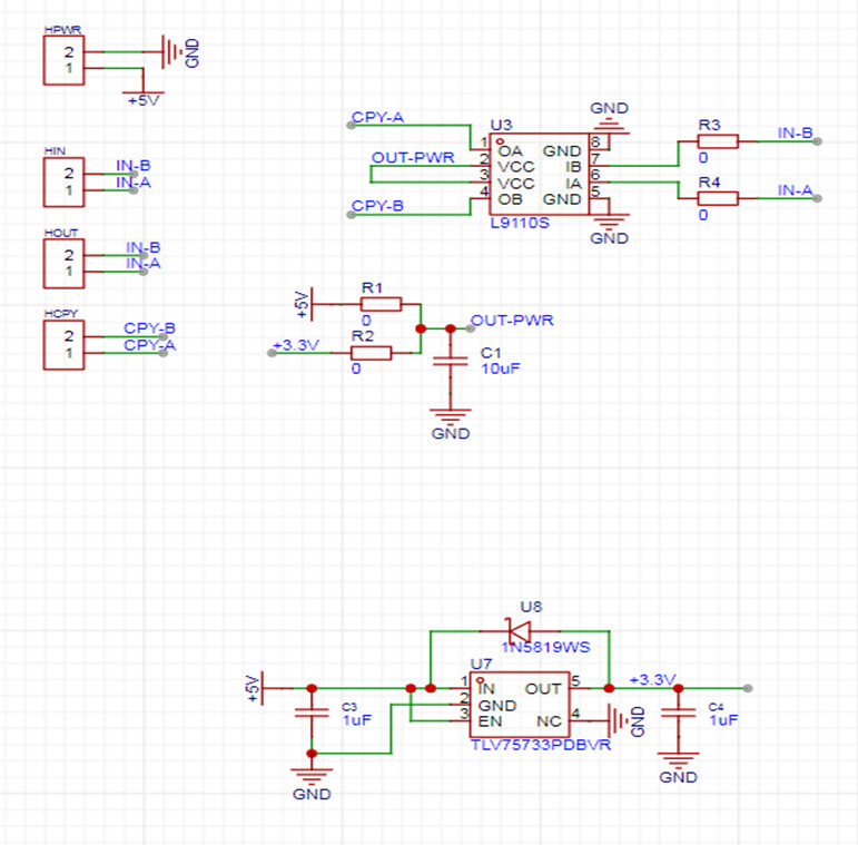

Each amplifier takes the incoming signal, amplifies it and splits the output it between an attached LED string segment and downstream to the next amplifier. For the amplifiers, I am thinking of using an H-Bridge like the DRV8876. which seems to have enough power and fast enough switching. I am thinking of using DC 5V power, relying on PWM to keep the LEDs from frying.
Does this setup sound feasible? Is there any advice for signal conditioning, splitting the H-Bridge output, etc.? TIA!

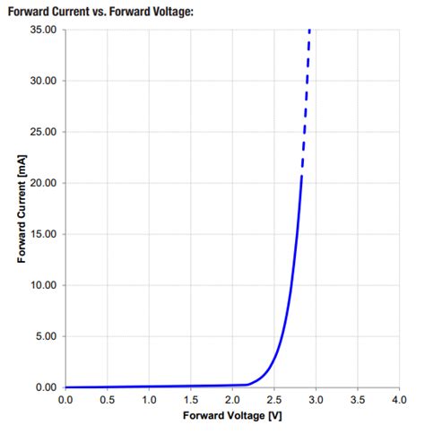

What limits the current?
I see this mentioned all the time, since I first starting doing LED projects 3 years ago. Practically, the current seems to be determined by the voltage applied, which is why 'current-limiting resistors' are used to lower voltage to the recommended forward voltage if required.
You are welcome to convince me why my eyes are wrong.
Yes, but you just said LEDs. No mention was made of them having built in resistors.
Anyway, how much current is used in total, and why do you think that you need multiple drivers?
Of course it is. That is a basic law of physics. However, driving a 2V LED with a 5V source will nearly instantly destroy the LED due to excessive current and heat generation, IF the source is capable of meeting the current demand.
That is why people use a resistor or constant current circuit to limit the LED current to safe values.
The big big thing that you seem not to know is there is not a linear relationship between voltage and current. It looks like this:-
So nothing until you reach the turn on voltage of the LED, which depends on the colour of the LED, then it shoots rapidly upwards. A resistor is the simplest way to limit the current, by approximating a constant current circuit. This sort of effect only kicks in when the resistor is more than about 80Ω.
Using PWM Is not going to save them in any way.
Your eyes follow a similar logarithmic sensitivity curve, that is they are not very sensitive to absolute values. So if you over drive your LEDs they will slowly fail, along with the device which is supplying more current than it should.
You can measure this drop in light output with specialist equipment after about a week of them being on. This light drop can be used estimate the half life of the LED. That is where the light output drops to a half. Your eyes will probably not be able to spot this, because they are not as good as you think they are.
If you are not convinced then why do you think that they have such specialist equipment to measure the half life of an LED?
Conclusion :- All LEDs need something to limit the current, the simplest being a resistor.
I finally put a scope on the commercial driver, and found it was outputting 3v with a PWM of around 8hz (much slower than the recommendations I had googled up). So I'll be doing some reprogramming.
Meanwhile, I implemented the repeater module using the L9110S. 5V for connecting the modules then dropped down inside the module to 3.3V for the L9110S supply using an LDO with which I was already familiar.
(R1/R2 resistors are for statically selecting the supply voltage, R3/R4 are an attempt at providing for signal conditioning if necessary).
Seems to work like a charm.

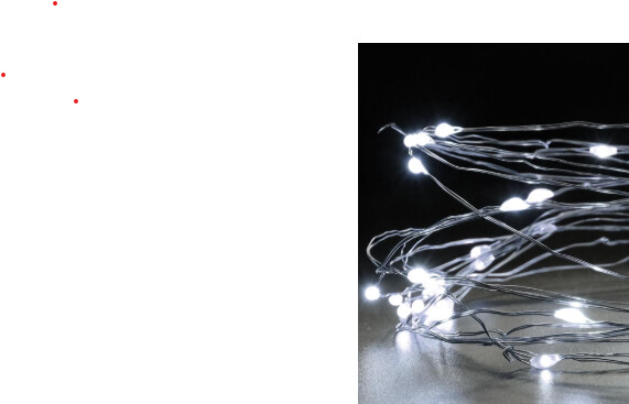

Below is the type of LED string (mine are same but with 1.6cm pitch, about $0.40 a meter - custom order). LED blobs are about 2mm wide (0603 chips). Maybe there is a resistor in there somewhere.
