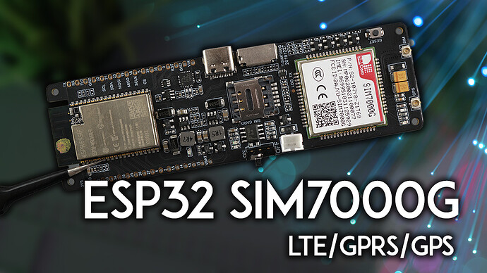

Did you have a look at the LILYGO T boards, they have lipo connector and most versions have battery protection.
These look good, they even allow for GSM communication aswell. I will probably be using this in my final design to save space, but in the meantime for the prototype, as time consuming as it is, I will just be sticking to the plain old esp32 and gsm module and probably a 10,000mAh rechargeable battery. Do you have any specific module names for the rfid reader and gsm module I should probably be using? Also, when considering modules to use for a project, how do you go about finalising your decisions before purchase? I’m new to this and there seems to be alot of things I can use for my project so it is a bit overwhelming haha
