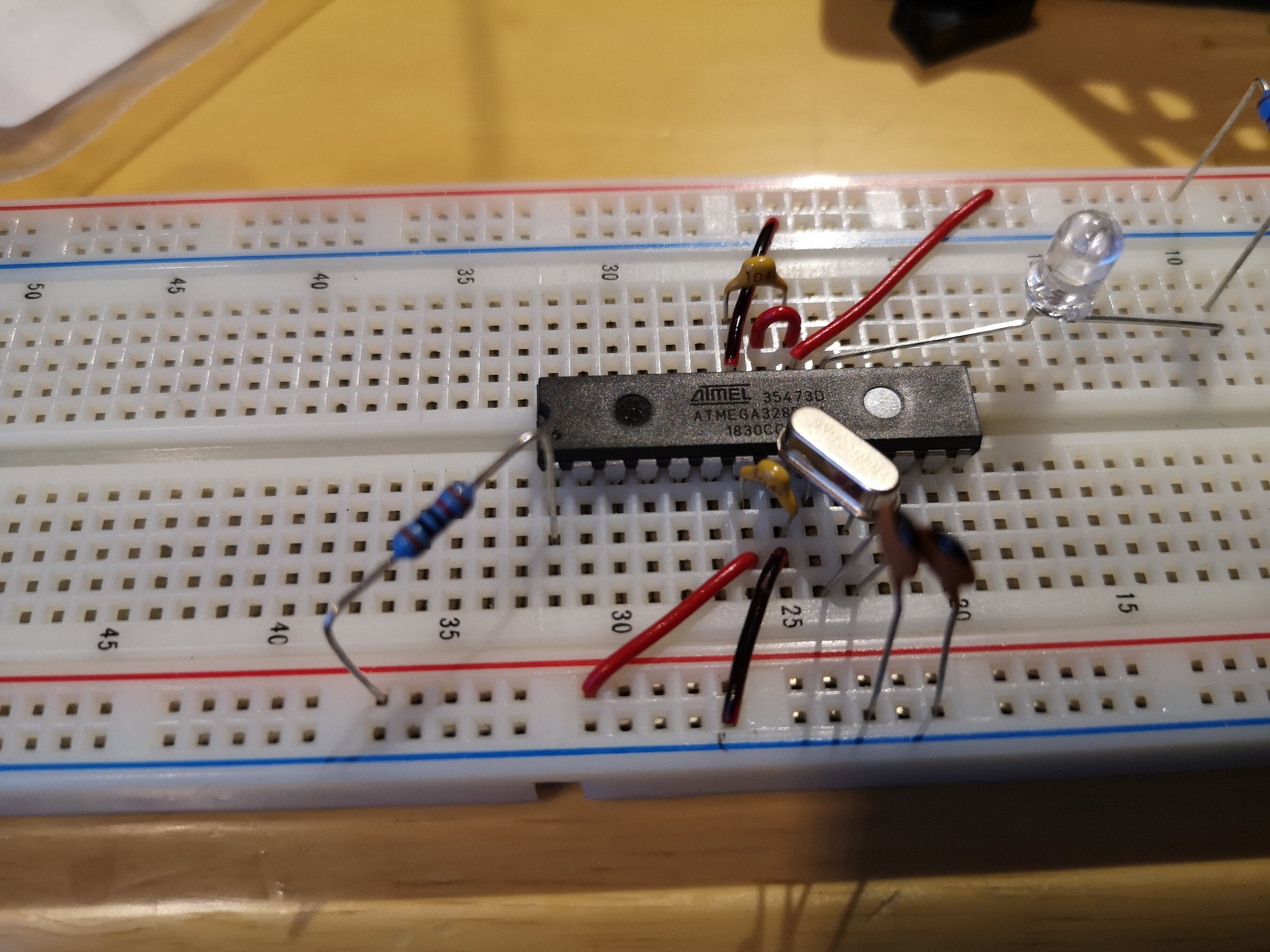

I'm trying to do bare bone ATMEGA328 from this tutorial: https://www.hdhprojects.nl/2017/11/21/15/
I don't know fuses, I select arduino pro -> 5V 16MHz ATMEGA328 on arduino ide and hope it put them right? Also I skipped bootloader as I send sketch directly to board -> chip does work if put on UNO board (yay ^^)
But of course, it didn't work on bread board. I started to look bit more help and there was a lot stuff about fuses and full swing oscillators and stuff.
I used HC49/4H: https://www.mouser.fi/datasheet/2/445/830003240B-2005173.pdf and I dont have any idea is that fullswing...
I dont know where to even start looking for? everything else seems to be ok, but oscillator was easiest to start.
Let's see a schematic of what you have built.
As I have never done anything with resonators / oscillators, I followed tutorial physical connections as closely as possibly to see if its working (used that schematics:
only exception was 9,x kOhmh resistor to pull reset up, but that should be close enough.
Yeah, I always use 10k but 9k2 would work fine.

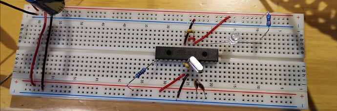

Can you post a photo of the physical layout?
I'm missing something rather essential int he schematic though: the power supply decoupling capacitors. They should be present on both Vdd pins and preferably on Aref as well. Use 100nf.
Sometimes with a non-starting ATmega it helps to put 100nF or 470nF between RST and GND so there's a brief delay in RST going high giving the power supply the possibility to stabilize before the ATmega starts.
Ill do when I get home.
I do have somewhat stable "lab power". but could try that capasitor between GND and reset
Don't forget those decoupling capacitors. Not having them is bad practice and can result in problems. Refer to the ATMega328 datasheet for design considerations and search for the Microchip/Atmel application note on crystal oscillator layout.

Sure, I overdid everything, new crystal and 22pF caps. Led has 330ohm resistor (~9mA)
and closeup
Ill check that out
Edit: wtf, it worked, I measured blinking voltage on pin 19... my led was "broken", I gave it DC Voltage up to 5V and it didnt burn at all, then it flashed and started to "work"... (its flickkering :smiley:
