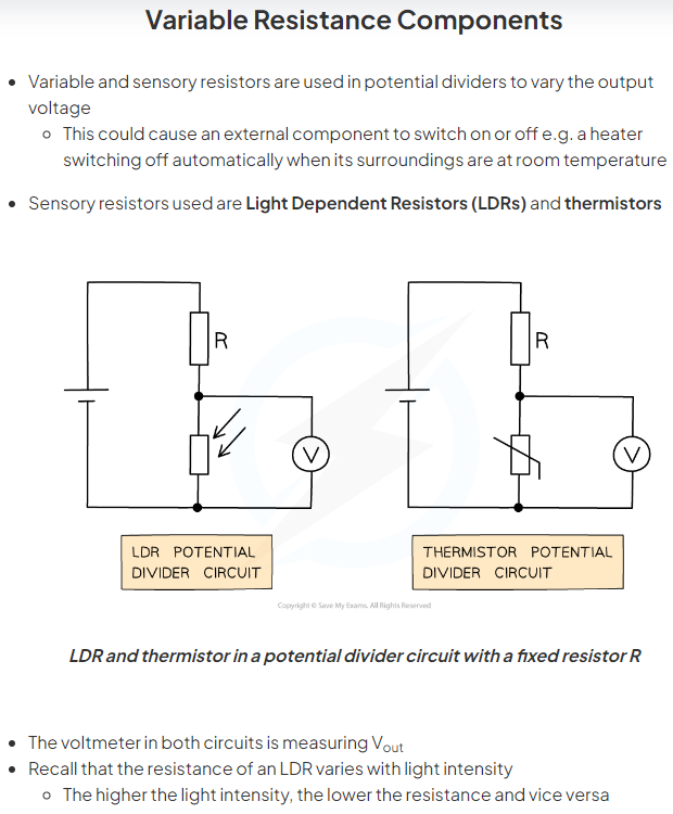

What you're doing is forming a potential divider (aka, voltage divider) with the LDR and the resistor:
So you choose the value of the fixed resistor to give a suitable Vout to your ADC over the range of light levels of interest.
