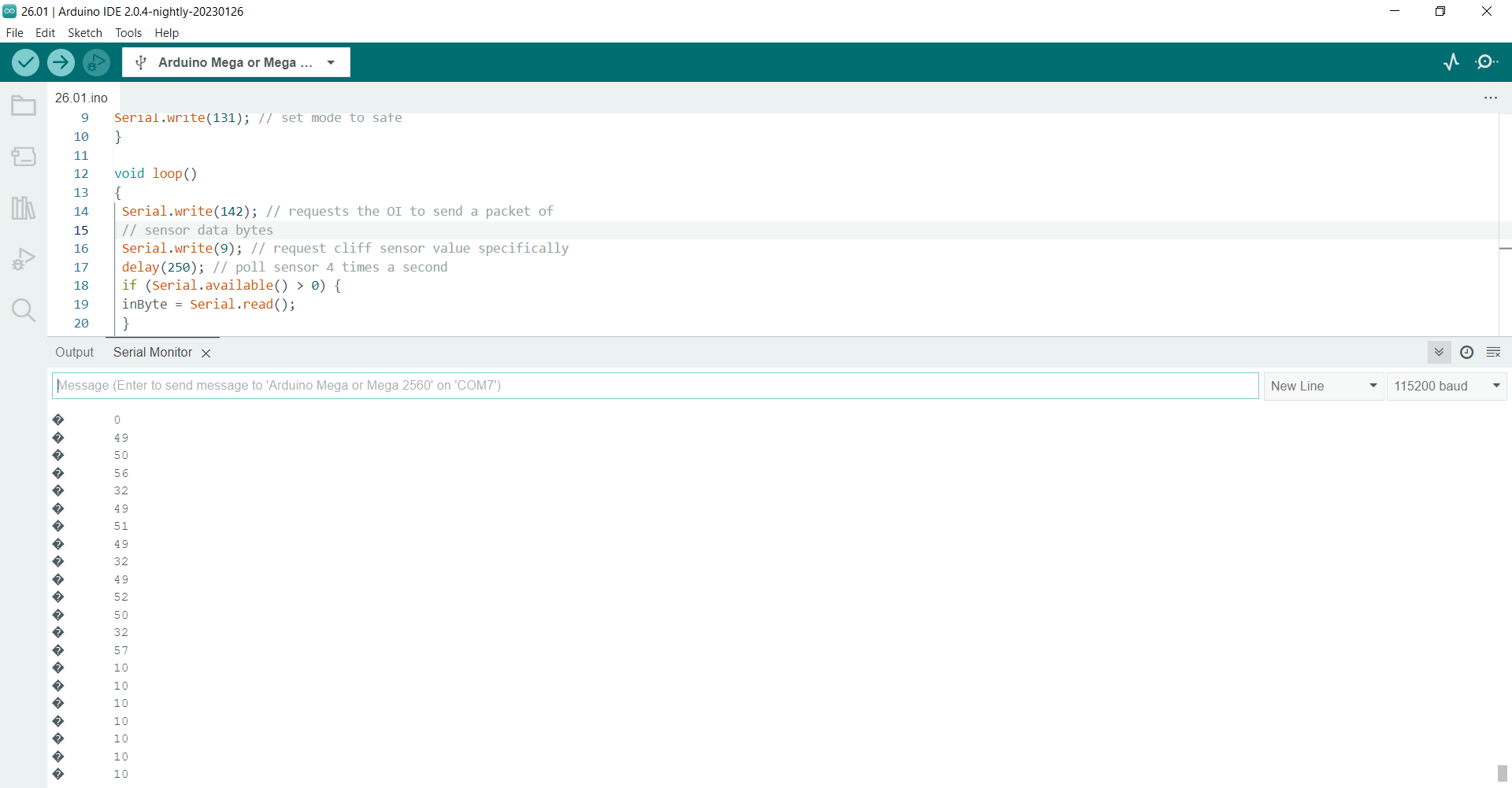

I am working on a project involving a Roomba 600 series controlled by an Arduino Mega 2560 microcontroller.
I have serious trouble in establishing serial communication between both. I have been using a baud rate of 115200 (default) and Serial1 (RX1 pin 19/TX1 pin 18).
I am trying to get data from the left cliff sensor. According to my code, when the robot touches the ground I should receive logic 0., whereas when the robot is not touching the ground (I lift it) I should be receiving logic 1.
Please check my code below or advise me for any other solutions for serial communication between Roomba and Arduino Mega 2560.

int inByte = 0; // incoming serial byte
delay(2000);
Serial.write(128); // This command starts the OI.
Serial.write(131); // set mode to safe
Serial.write(142); // requests the OI to send a packet of
// sensor data bytes
Serial.write(9); // request cliff sensor value specifically
delay(250); // poll sensor 4 times a second
if (Serial.available() > 0) {
inByte = Serial.read();
Serial.println(inByte);

should you be sending commands to and reading data from Serial1?, e.g.
  delay(2000);
  Serial1.begin(115200);
  Serial1.write(128);  // This command starts the OI.
  Serial1.write(131);  // set mode to safe
  Serial1.write(142);  // requests the OI to send a packet of
  Serial1.write(9);  // request cliff sensor value specifically
  if (Serial1.available() > 0) {
    inByte = Serial1.read();
  1. About safe mode, according to the manual "This command puts the OI into Safe mode, enabling user control of Roomba. It turns off all LEDs. The OI can be in Passive, Safe, or Full mode to accept this command". I call it using "Serial.write(131);". I have also tried using Full mode but same result.
  2. As shown in the first picture below, I receive logic 0s when robot is both touching the ground and not touching the ground.
As shown in second and third
picture, after sending commands for initialisation of the robot and left cliff sensor request, I receive true values no matter the situation of the robot (touching or not touching the ground).
