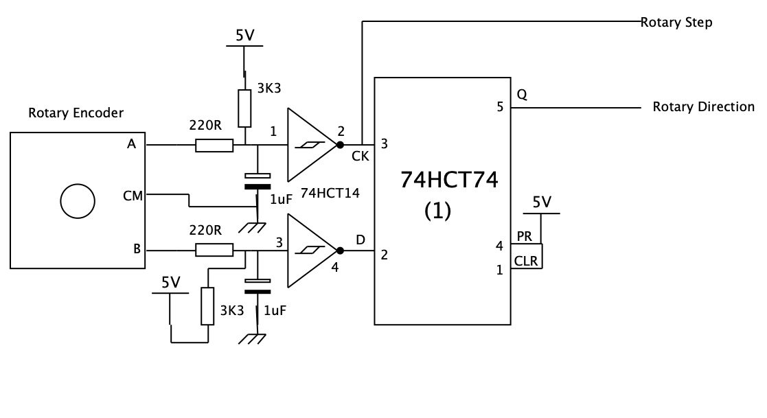

Alternatively I have used this circuit for converting the output from a rotary encoder into step and direction pulses.
Hope that helps.

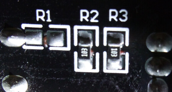

The one with built-in pullups is the problem – the only time it works is when the on-board pullups are enabled (by tying encoder V+ to Vcc). Processor pullups – pinMode(X, INPUT_PULLUP) appear irrelevant to this encoder.
I would say that is what I would expect to happen. The internal pull up resistors are quite weak with a range of values between 33K and 50K. If you then go and put a floating 1K resistor in parallel with it then I would expect the internal pull up resistors to have no effect.
It's hard to see but, the built-in pullups are 10k.  Paralleling that with 33k gives 7.7k, no?
Not if they are floating. This is why you have to connect them up to the power to get it to work.
probably R1 is meant for pull up momentary press switch
Yes, Getting bleary eyed. I'll take this up tomorrow.
