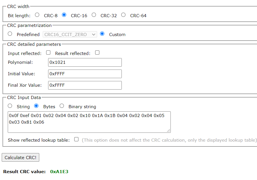

ok so im still going around in a circles here unfortunately.
wrt to the CRC. does that need to be calculated on the nano as i read somewhere that they are stored in the eeprom?
so if i simply send the crc byte will it not work?
I have extracted code that i found in the github genibus code as below: (they state that this is for datalink.ino/

am i perhaps sending the correct values but because the nano is not caculating the crc it is not working? :confused:
ok so i have now modified the code to work with hardwareserial and i am getting a different response as attached.

it appears as though i am getting a response which does not include the start delimiter reply of 0x24.
the length and destination is correct as well as the source address
The CRC is definitely not stored in EEPROM. The CRC should be calculated on the fly for every message sent. Unless of course you are sending a fixed predefined message in which case you would know the CRC beforehand.
The code you posted in #23 looks like it is preparing a message to be transmitted. The sendPDU function does all the work of assembling the message and calculating the CRC. The message is then written to the hardware serial port.
I would try and track down the actual CRC library that they are using. I'm not a CRC guru so I don't know enough about the Ardiuno CRC library to know if you could use that instead. The documentation for that library suggests that you can set the polynominal, initial and final values.
Just spotted something which may be relevant. In your latest code, the pre-set message msg1 is talking to a destination address of 0xEF. The earlier successful messages were going to destination address 0xE7.
Also, I can't see anything in the code in #23 that is controlling the transceiver of the RS485 line driver. That may be because they were using an RS485 line driver with a built in switch-to-transmit capability. There have been a couple of cheap RS485 modules that didn't use RE & DE signals at all.
If the code you posted in #23 compiles, then you should be able to modify it to work with the RS485 module. In the sendPDU function, change the for loop at the end to something like:

I managed to get the developer login to the software whereby i was then able to see all parameters and also dev debug the software and control the unit from software side.
i could then also view and filter the start/stop PDU communication between the software and the unit.
I also hooked up the pc tool usb-rs485 connector AS WELL as the arduino-max485 A & B line SIMALTANEOUSLY to the unit.
The end result is that i have now got the unit working and functioning as required.
A MASSIVE thanks to @markd833 for your assistance with this project. Your input and help was instrumental and I truly appreciate it a lot. Thank you.
My working code is as follow. (i will be tweaking it here and there, but it is working as desired for right now)
