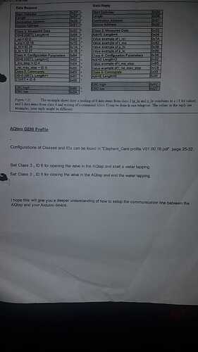

Good day,
I am really struggling to understand how to interpret the spec sheets attached and send the correct byte values over rs485 from my arduino.
I have connected everything correctly etc. but I do not understand how to ie. set class 3 id 6.
I requirements are:
1.) to set class 3 to id 6 to open valve
2.) to set class 3 to id 5 to close valve
I presume i then need to do a crc check ?
any advice would be greatly appreciated.
thank you.

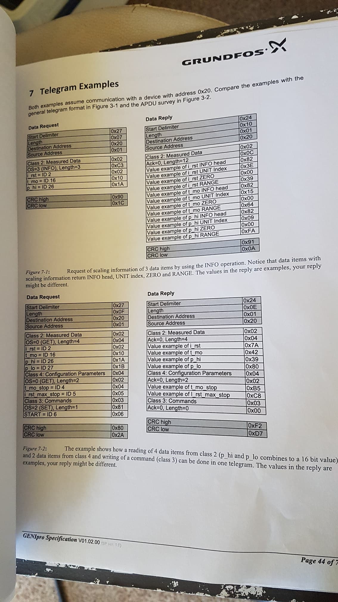

Looking at the first image you posted, then, yes, you need to calculate a CRC16 checksum for the message you want to send.
EDIT: there's a GENIBus-Arduino library on github that might do what you want.
ok i am still pulling my hair out.
that Genibus library does not make sense to me. in the example code it also states that there is an arduino arror and that it is still to be completed.
i have tried modbusmaster library, simplemodbusmaster library, a simple sketch which creates a byte array with ie:
0x27, 0x0F, 0x20, 0x01, 0x02, 0x04,, 0x02, 0x10, 0x1A, 0x1B, 0x04, 0x02, 0x04, 0x05, 0x03, 0x81, 0x06, 0x80, 0x2A as per the specifications for a data request per the attachment that i uploaded and i get nothing...

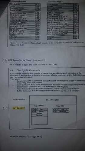

the spec sheet says that i need to set class 3, id 6 for opening of the valve & set class 3, id 5 for closing the valve.
am i missing something major here or misinterpreting how to send those values from my arduino sketch to the max485 tranceiver.

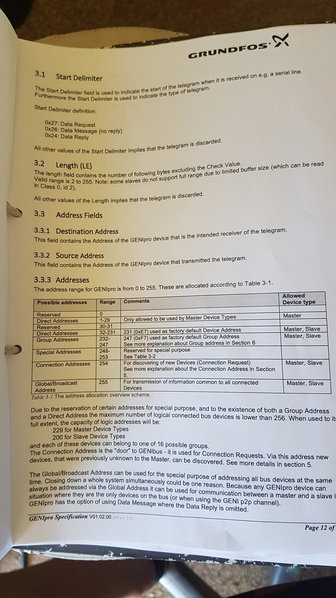

as far as I read your pictures, your module doesn't use modbus. Or do you find any description in your documents saying Modbus RTU?
I do not see Modbus anywhere no. :confused:
The attached shows basicly all i can find in the 100 odd pages that actually seem useful. :slight_smile:
I would forget Modbus. As @noiasca says, your message format isn't Modbus.
You could try sending one of the pre worked messages from the docs to see if you get a response using a software serial library and controlling the MAX485.
Here's an untested bit of code that might work for you:

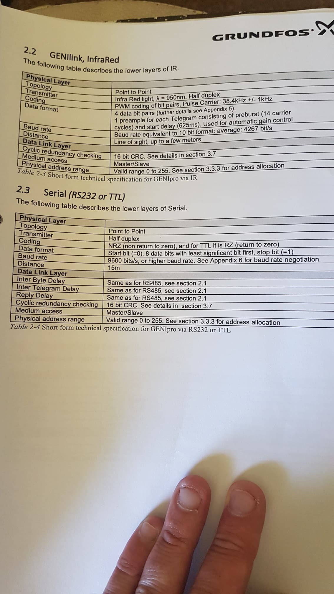

It uses a software serial port (AltSoftSerial library) to talk via the MAX485. It should send the canned message that's in your reply #4, and then wait for 2 seconds printing out any bytes that are received.
The software serial port can go up to 31250 baud according to the docs.
Maybe I missed it, but I couldn't see a baud rate in the images you posted.
There's a very good chance that you will get no response, as your valve probably has a different address to the one used in the canned message.
If you have to change any of the message, then the CRC will be wrong. Section 3.7 of your doc gives some clues that I used to create the same CRC using an online CRC generator.

In the spec sheets i see that for baud 9600 there is :
an inter-byte delay of <=1.2ms
inter telegram delay of >=3ms
inter telegram delay after data message >=50ms
Reply delay [3ms-50ms]

Looking at the first photo in your post #1 (and photo 4 in post #10), the 0x0E value in the above message is the length field. If you send the message in the current code, then the length field value is not correct.
The delays in the spec shouldn't be a problem. I would have thought that the inter-byte delay would be less than 1.2ms, even with a software serial port implementation. There's a 2 second wait for a response which is much longer than the inter telegram delay.
Probably of little use to you but I think that there is an error in the example message in the photo in post #1. The connection request message says that the destination address ix 0xFE, but the connection reply message says it's coming from address 0x20. I would say that photo 1 in reply #4 is correct as far as addresses go.
As there is just you and this 1 device on your RS485 bus, then I guess that the source address (i.e. the Nano) can be any address other than the address of the other device. Do you know what the address is of the other device?

OK so these two pages might be of more assistance.
i put the lines through the hex (send) as i was trying to ascertain the bytes/packets etc.
