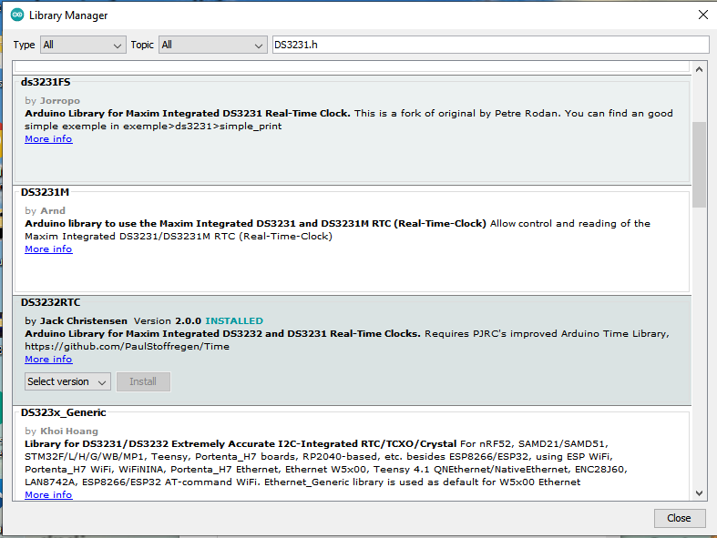

Can you try to identify which DS3231 library you have installed. Look under Sketch -> include library -> library manager in the IDE. You'll see something like this:
The problem you describe, that is extremely bad timekeeping from what is supposed to be a precision device, could be due to the library somehow returning the Arduino system time instead of the time obtained from the RTC.
Also, and possibly related, you are calling the method getTime() every 5 milliseconds which is an unusually high rate. Maybe try calling it every 1 second just to see if there is a change in its behaviour. Something like:
