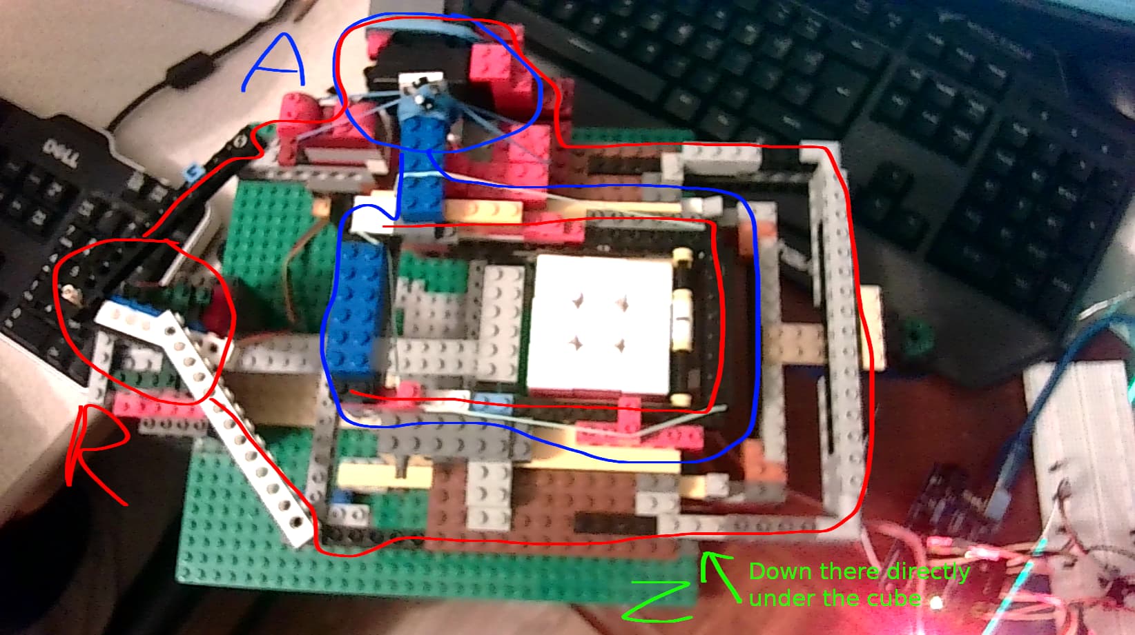

I'm currently building a Rubik's cube solving robot out of Legos, with an Arduino uno to run the three motors and to interpret the notation I give it (mod edit link removed).
I'm going to use this forum somewhat as a blog, however I put it under this section because this is the first time I've used Arduino and I already need help.

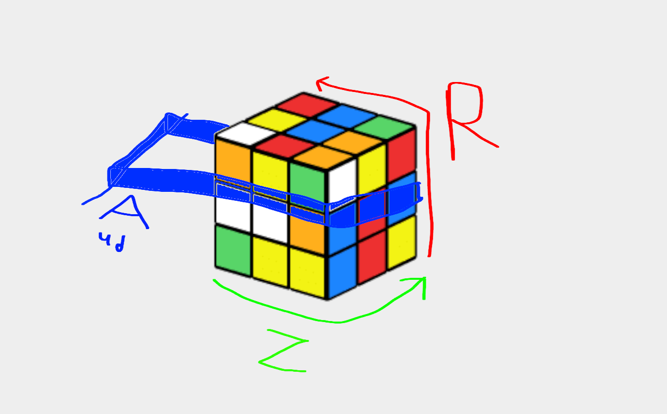

I'm using a servo, a DC motor and a step motor.
  1. Z_step-motor turns the base (or the whole cube) 90 deg at a time. I am only going to have Z turn one direction for simplicity in the code.
  2. R_DC-motor rotates the whole cube once, on the x axis.
  3. A_servo-motor lifts the arm to enable Z to rotate the entire cube on the Z axis, instead of just the lower slice (in the code 'Au' for arm up and 'Ad' for arm down).
My goal is to use only the Arduino uno kit I have for this robot.
My first problem is the code and wiring for all three motors.
This is a very rough draft code for test controlling the servo and step motor.
As you can probably tell, this code does not quite work properly.

This feels like finding a needle in a haystack...
Please explain what exact problem you have with this code.
Most here will not take the effort to first find your problem and then solve it..
Only two faces with a common edge need to be rotated to solve every combination.
