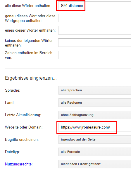

By googling focused on the website of https://www.jrt-measure.com/
S91 distance site:https://www.jrt-measure.com/ - Google Search
I found this video
How to test 10m LiDAR Sensor IP54 - S91 - JRT

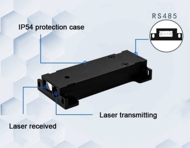

The 10m-type has a RS485-interface. Which has a very different electrical characteristic than standard TTL
You will have to specify much more precise which S91-sensor you have as there are
two of them

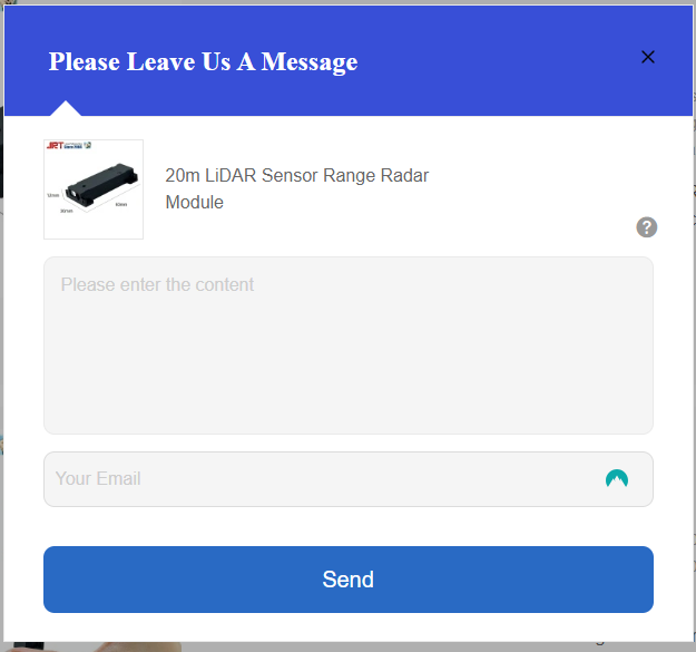

S91 Manufacturer, China S91 Supplier
On the website you can use the
button
to send the manufacturer a request
I was curious about the reaction of the manufacturer so I send them a request myself
This is what they answered in a first email
Model#: S95
Measure range: 0.03~10m/20m are optional
Power supply: 5-32VDC
Output: digital RS485 output
All documents will be sent to you once we got your reply to avoid enter spam. waiting for your kindly reply.
What is a bit strange I sended the request based on this product
S91
and got informations about S95
Anyway it says
You will need a RS485 to TTL-Adapter if you want to connect this sensor to a microcontroller
