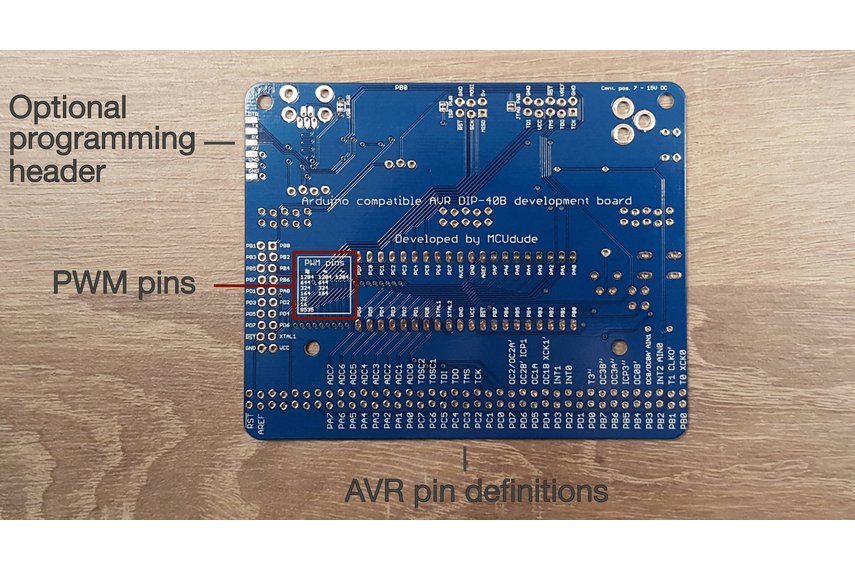

You should check out my development board I sell --> DIP-40 Arduino development board. It's designed together with MighyCore, which is the most feature rich and updated ATmega8535/16/32/164/324/644/1284 Arduino core. It got all the functions you need on a dev board (plus the AVR pinout, not only the Arduino pinout) including:
  • a double IO row (both male and female)
  • onboard potentiometer for analog reference (LCD contrast for instance)
  • an onboard USB to serial adapter
  • It actually beautiful (compared to other dev boards around here)
@hansi your board looks really beautiful.
