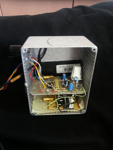

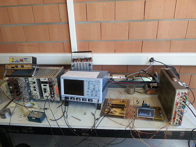

My arduino is aquiring data from a circuit with a scintillation cristal in order to measure the spectrum of radioactive sources. It is displaying instantly the histogram on a lcd screen and the number of the channel of each hit is displayed in the serial output. So in order to be able to save the histogram created, I'd like a way to say to the program that it should save it into a file.

So, yes, it's a physics experiment. It's a small setup for the practical work of physics students. I only have one cristal, so the energy range is limited but good enough for the purpose of this experiment. The scintillator is connected to a PIN diode which is in turn connected to a pcb specifically designed for this experiment. The most important part of the circuit is the sample and hold feature that holds the signal detected long enough so that the arduino can read it and process it. It's quite nice and it's starting to work well but the setup is not fully finished yet, so the video will maybe come later, ^^.

So here are a few news about this experiment. It is able to acquire data from a detector made of a scintillator and a PIN diode or from a PhotoMultiplier. It will display directly the histogram of the spectrum on the screen connected to the Arduino. When the spectrum is thought to be good enough, one can press a physical button connected to the Arduino in order to save the actual histogram into a file. I find this method much more efficient and useful than using a terminal emulator and saving each entry in the file. I guess that will depend on what data you have and what you want to do with them.
Here are the final version of the files that allow to do that, maybe this will be useful to someone.

And here are a few pictures of the setup and the detector, :slight_smile:
And one more, sorry for the number of posts, but the pictures are too big ! ^^
