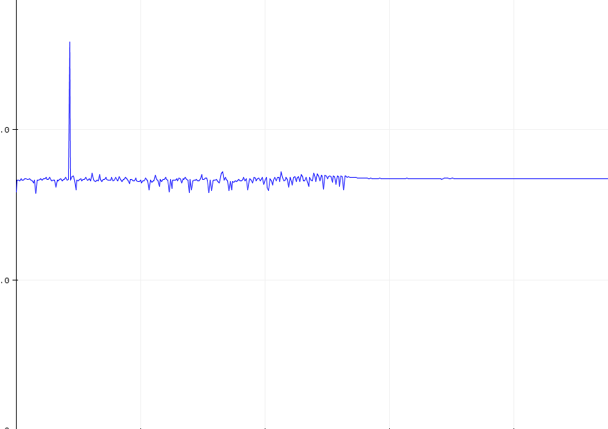

However I am not getting the output that I should:
I have separately tested the 74LS14 IC with high and low voltages and it works correctly as an inverter. I have also tested the resistor and capacitor separately with a square wave input and got charging and discharging waveforms indicating they are not faulty. Is the IC faulty then with regards to its threshold behaviour? Any help is appreciated. Thanks.

If you look carefully at the data sheet for the 74LS14, you will see that the recommended maximum output current (IOH) is -0.4 mA (negative because it is output current).
A 1K load resistor will draw 5 mA when the output is high, so you are exceeding that recommended limit by a factor of more than 10 when the capacitor is fully discharged, somewhat less at other times.
The output (feedback) resistor should be 10K or higher.
LS TTL is a poor choice for a low frequency oscillator, especially with that circuit. Use a CMOS Schmidt trigger with a totem pole output or an op amp circuit instead.

1K is pretty small: you would drain a low of current on IC. You drain 3.3mA. Datasheet tells me: "high level output current: -0.4mA".
I guess, 1K is way too small - try with 100K (at least 10K) and 10 microF.
Your IC seems to clamp. I guess, because the resistor value is way too small. Imagine: you would feed the output via 0R to input: It is inverted, the IC tries to oscillate (with full speed it could do). But there is this huge C: it will low pass filter the "self-oscillating" frequency and your IC does not see anymore any frequency. It hangs at a random level.
On a 3V3 logic, assuming 1 mA current - a resistor is already 3K3. I guess: your 1K is your problem (and going with 100 microF is also pretty tough):
  • increase R1: I would guess: at least 10K, up to 100K
  • for same time constant (Tau): lower C1, e.g. 10 microF (with lower capacity it is anyway better because the inrush current is also lower, for a shorter period of time: 100 microF is pretty huge and creates a huge current taken or provided for a long period of time).

  • tie all unused 74LS14 inputs to VCC or GND.
  • add a 0.1uF decoupling capacitor from 74LS14 pin 7 to pin 14.
  • use a 10K or high resistor in your RC feedback circuit as suggested earlier.
The spike in your plot shows that the output is working, but can't oscillate (see above suggestions).
