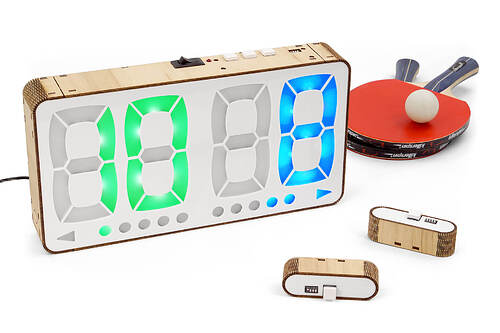

Hey guys.
I finally got around to documenting my Scoreboard!
I currently have it coded and setup for Table Tennis:
Features:
  • Large 5" bi-color 7-segment numbers
  • Ultra power-efficient display
  • Tracks points, games, server, and sides
  • Wireless buttons last 5+ years on a coin cell
  • Display itself can also be battery-powered
  • Mounts to a wall, cubby, tabletop, or tripod
  • Pre-programmed to play official table tennis rules
Adjustable parameters:
  • 5, 11, or 21 point games
  • 1-5 games-to-win per match
  • Player starting side (or random)
  • Server starting side (or random)
Materials:
  • Mahogany based plywood
  • A variety of plexiglass
  • 9 printed circuit boards
  • Lots of electronic components
Display housing size:
  • 13.0" x 6.8" x 2.0"
Button size:
  • 3.6" x 1.1" x 1.1" (not including nub)
More Pics / Info
Open Source Files
Assembly Instructions
Thanks for looking.
-Josh!
