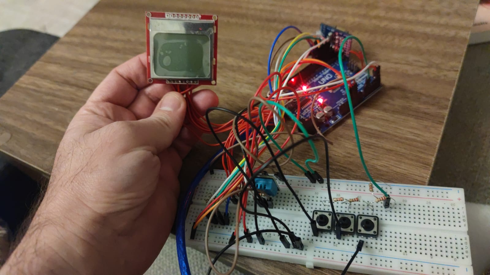

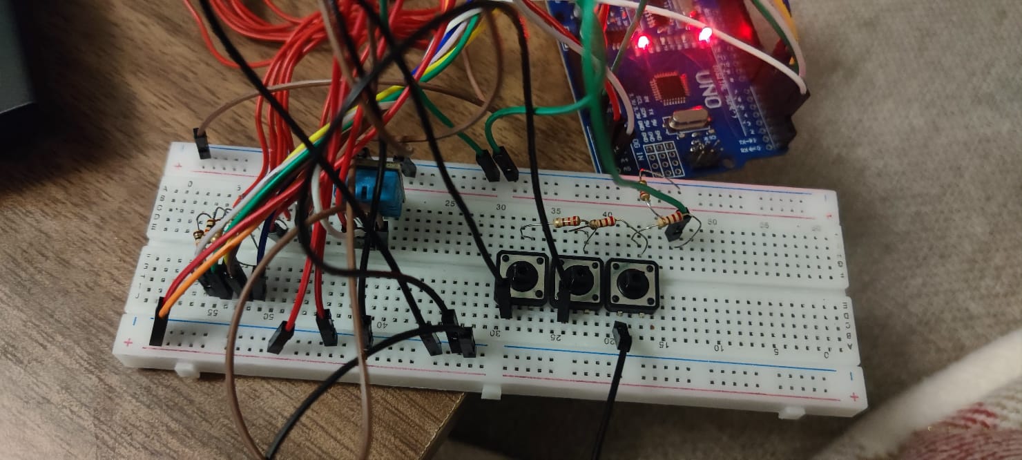

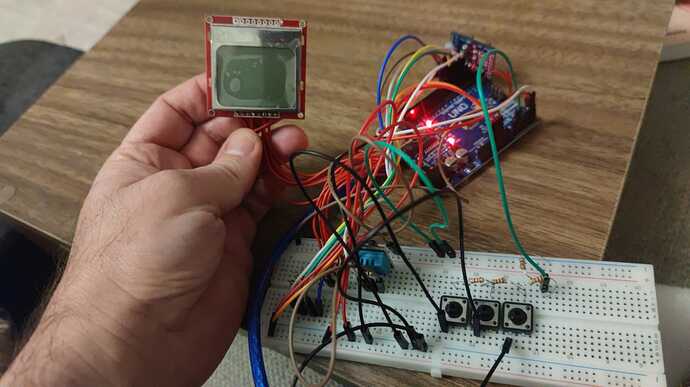

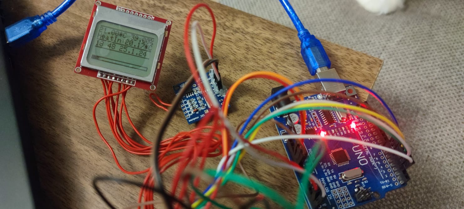

Screen shows nothing after a time on Nokia 5110 screen
hello,
I started a new project to make a clock and to show temprature and humidity also. I completed my code which is below and working withouth problem. but my problem is after a while screen shows nothing and not responding my button comments also.
I added my code and prictures of my project. I somebody could assist me to solve this problem and if you will have nay suggestion to make my code better, I'll appriciate.

When you compile (or upload), would you copy/paste the memory report from the serial monitor window of the IDE?
my code is using 70% of storage 66% of dynamic memory.
Sketch uses 22598 bytes (70%) of program storage space. Maximum is 32256 bytes.
Global variables use 1363 bytes (66%) of dynamic memory, leaving 685 bytes for local variables. Maximum is 2048 bytes.
You are using pins 2 and 3 twice...
I am certain you have copy/pasted two sketches together... which is okay to do, but you must verify these conflicts are resolved. Maybe start with just one sketch to verify your screen...
Try this tutorial... made by Rui Santos, who is a known author...
So how long is a "while"? Are there whiles of different length? How do you know that Arduino is not responding to the buttons? Your code might be kosher, and your problems are all down to mechanical issues with the 5110. You might be able to verify this by copying display commands to the serial monitor.
