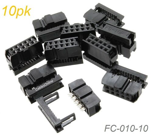

I'm a big fan of the IDC connectors. So much faster than those darn dupont connectors you were using. The main downside for me is that they're a bit less friendly to use with stripboard since they use a 2X pin pattern, but you can use a utility knife to cut the strip between the holes. The other downside is that the minimum size is 6 pins. You can buy the IDC tools pretty cheap and the tool quality isn't really a concern. I'm sure you can make cables even without the tool, but it's probably worth $13-16 (depending on whether you wait for China shipping) to make your life easier:
These are what the connectors look like:
They are available in sizes from 2x3 to 2x32.
You just cut some standard ribbon cable to the length and number of connectors you want, then clamp an IDC connector on each side and you're done. No stripping of the wire is needed because the connector pierces the insulation. You can get the connectors with built in strain relief it you like. I've found even without the strain relief, they are pretty durable because the insulation is keeping a lot of the strain off the connection between the connector and the wire's conductor.
The connectors are keyed and you can get shrouded male headers which will only allow the cable to be plugged in one way. They don't have a lock, but even the 2x3 connection is quite secure. They were used on millions of hard drives for many years.
