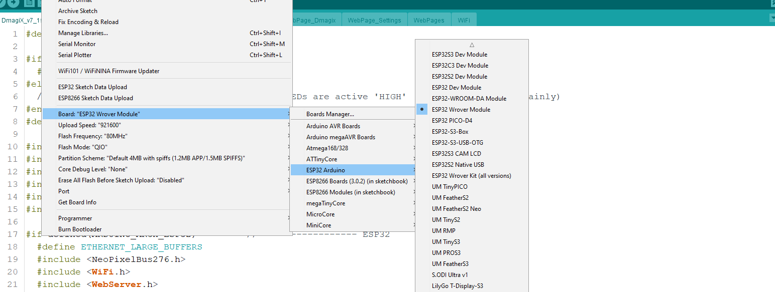

The ESP 32 is the ESP32 Wrover Module which plugs into a Development Board.
The Development Board is here:-
Garry
That board is meant for the 38-pin devkit. The Wrover has a completely different pinout with power & GND pins in different places.
Please show us the exact ESP32 board (Picture) and where you got it from. (link)

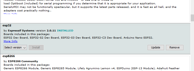

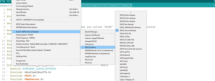

which core version of what do you have installed ? what do you mean by 'arduino core' and 'espressif core' ?
What you should have installed is the ESP32 core by espressif,
but try an older version, not any of the version 3.x.x (i'm using 2.0.11 as you can see)
select the esp32 Dev Module
and also try the Esp32 Wrover module
Indeed, I use 2.0.14, seems to work with most libraries, newer versions do cause issues with various libraries.
