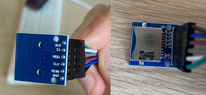

I am using a Wemos ESP32 S2 Mini with a simple 3.3V SD card reader connected over SPI.
I can successfully mount the card and read properties such as totalBytes(). But reading files fails, and writing files appears to work, but does not actually save anything to the SD card. The biggest problem is, that every now and then writing destroys the card (maybe based on how the card is partitioned or how much I write).
Board: S2 mini — WEMOS documentation
Card reader: Otronic 3.3V Micro SD card module voor ESP32 | ESP8266 - Otronic (looks slightly different than on the pictures)

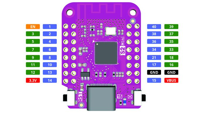

How did you format them? Using SD Memory Card Formatter for Windows/Mac | SD Association? If not, try that.
Which SD library is being used? You might have to enable verbose output during compilation in file -> preferences in the IDE to be able to see it. As far as I know (not an ESP32 user) it has its own library but the IDE might have decided to use the standard one.
Is this
or this
or this
how your MCU looks?
because this
#define SD_POWER_PIN 38
#define SDCARD_CS 34
#define SDCARD_MOSI 35
#define SDCARD_SCLK 36
#define SDCARD_MISO 37
can be problematic depending upon the ESP32 being used. Post an image of your project with the ESP32 prominent.

The first picture is how mine looks (S2 Mini).
This is the sd card reader
What happens when you try with the spare micro sd card reader?
What happens when you don't set the SD card reader pins, I dont' with...
Both my sd card readers give the same results.
I tried (with sd power directly connected to 3.3v on the esp), but then it simply fails to mount the sd card. Same if I provide the SS/SC pin only.
Okay, the problem is finally solved! Thanks to Idahowalker, I temporarily powered the sd card reader directly from the 3.3v pin on the Wemos ESP32 S2 Mini. With the SPI ports set through the code again, I was finally able to write to the SD card without breaking it.
I tried again with:
  pinMode(SD_POWER_PIN, OUTPUT);
  digitalWrite(SD_POWER_PIN, HIGH);
to make sure that power is the problem. Apparently, the board cannot provide sufficient power over digitalWrite.
In short: the SD card reader needs to be powered directly from the 3.3v pin on the board!
