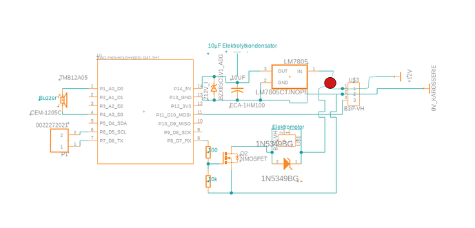

I've constructed two custom PCBs for two distinct projects. Both are designed for applications in a 12V car/truck environment. I'm experiencing similar issues with both, even though they have different designs to power a 12V motor.
Issue with PCB #1:
This Application uses a Mosfet and some Diodes and Resistors to engage the Motor.
I'm using D10 (MOSI) to detect a GND signal. I've enabled the internal pull-up resistor for this. When the device is exposed (no casing - and it's a solid aluminum casing), it functions correctly. However, when I place the casing on, anomalies occur.
When I activate the GND signal, there are times it detects and triggers repeatedly. At other times, it doesn't respond at all. I've added a buzzer to the PCB for feedback.

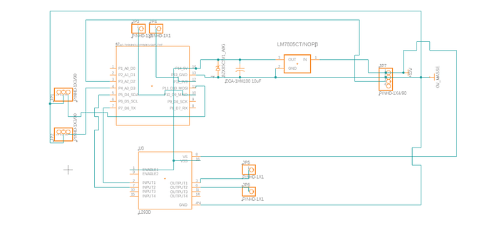

Issue with PCB #2:
This design employs an L293D to drive the motor in both directions.
For this PCB, I use a trigger signal to turn the motor clockwise. Additionally, I've incorporated a reed sensor to detect a magnet (positioned in the holder) which, when close, turns the motor counterclockwise.
However, I'm encountering a familiar issue.
Upon powering the unit, I receive sporadic trigger signals. For instance, when the motor is supposed to run continuously until a specific condition (like "Sensorbolzeneingefahren") is met, it unexpectedly halts and remains inactive until I re-trigger it. This happens even when the logical action would be to await the sensor trigger. Furthermore, the reed sensor is highly sensitive; merely approaching the cables with my fingers results in a trigger.
The reed sensor connects two pins on the Seeduino. Is there a method to detect this connection without applying current to them (akin to a pull-up)?

After extensive testing, I suspect the inconsistencies may stem from issues with the internal pull-up. Since all of them are used to detect trigger signals or sensor inputs. Are there alternative methods to utilize it? Or do i have a "stupid little mistake" going on?

The 7805 voltage regulator is missing the required input capacitor, and will need some additional protection against high voltage spikes in the extremely harsh automotive environment. See Transient Voltage Suppression in Automotive Applications

Also there is a 10uF Capacitor in front of the 7805CV, it actually works pretty well, didn´t have any defects till now, other than the Strange behaviour when it is in the Metall Casing.
You have been lucky, but it is just a matter of time.

I would follow the advice in the link I posted, and add TVS diodes, extra filtering, etc.
This is characteristic of voltage spikes in the power supply, resulting from inadequate power supply decoupling:
This is characteristic of a floating input, due to bad connection or lack of pullup resistor:

Can you give me a more specific hint what you mean by pullup resistor? for testing i´ve put a 10k resistor between the reedsensor and the Reed Input Pin. But it didn´t do much to reduce the sensitivity.
As i said, im greatfull for all your help, im noway a Pro in this segment, neither am i an electrician :smiley:
The 10K "pullup" resistor should be connected between the input pin and Vcc to define the pin state as HIGH when there is no input. Or use the internal pullup resistors with pinMode(pin_number, INPUT_PULLUP);.
The reed switch should be connected between the input pin and GND. digitalRead() will return LOW when the switch is closed.

Yes, from the motor shown on your schematic. Also, voltage drops due to inadequate wiring can cause brownout resets.

The Current Diode im using with the LM7805 is this one: bzx-85c5v1
and the following Capacitor
Do i switch out the BZX 85C5V1 VIS Zener-Diode for the TVS Diode? or do i put it between the 12V Incoming to the Board like this?
