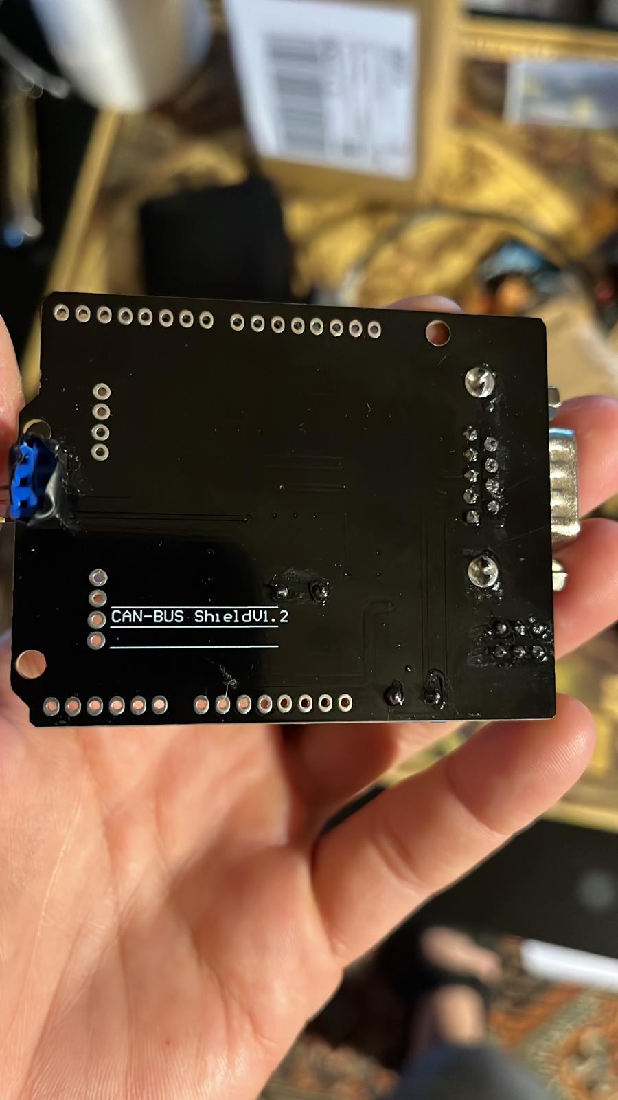

Also i cutted P1 at all and desoldered the R3. I am testing with car ( w204 ) and PCAN-USB FD. Both of them not works. Am connecting PCAN FD cable or car by DB9.

Thank you for your reply. Im kinda confused about the termination resistors. Im kinda newbie about the hardware stuff, sorry for that. When i read some about them on the Seeed studio forum, i saw people talking about the desoldering R3 ( resistors ). Before that ( when i purchased shield, without touch to hw ), i couldnt get CAN message from car or pcan fd usb. After removing R3 ( also cutting p1 ), still couldnt get CAN message :slight_smile:

Resoldered the R3:
As you can see, i cutted P1 at all ( I was really angry to shield after countless try)
Also i tried Elecfreak's shield. But still same issue:
From the schematic it appears P1 (should be a cuttable jumper) is the termination and R3 is the termination resistor, that should be about 120 ohms. The design leaves the termination resistor in the circuit so you are all set with that. P1 is in series with R3 so cutting and removing is redundant. Not all cars are the same or at the same baud.

You are close, the bus is 60 Ohm but it is comprised of 2 120 Ohm resistors one on each end. You can try without any as OBDII has some termination and see if you get anything.

Almost. Nothing on the SPI is good. With two shields and more the bus impedance is 60 Ohms. A bus is normally terminated at each end and not in the middle. The end point resistors should be 120 Ohm, one on each end. This was to minimize the signal reflections. 2 120 Ohm resistors on the bus ends gives you an actual value of 60 ohms that is what it should be.
If you have modules in the middle they do NOT get resistors. With OBDII try it both ways as I do not know how the bus is structured. At one point it was going to be a bus to the connector from a gateway, nothing else on the bus so you would need the resistor. To my knowledge there were three modes. User, Dealer, OEM, each comes with more privileges and retains the previous privileges. Things have changed in the past 20 or so years and I am no longer involved.

Couldnt receive from or write on the bus between two Arduinos. I think, i little bit destroyed my shields, because i used knife to clear missplaced soldered parts.
That would do it. Sorry it happened, you were so close!
