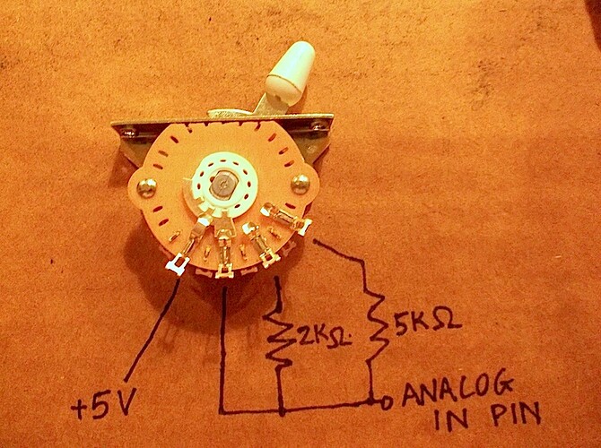

I have a MIDI controller using a Leonardo card and it works fine. I'd like to use a selector switch instead of a potentiometer. The idea is that I will have a 3 position switch that will change the amp module on my synth. I am familiar with MIdiPipe and was hoping that I could use a guitar pickup selector switch. The plan would be that I would attach it like a pot but use resistors to bring the signal voltage down in the different positions
I've attached two pics. The first pic shows the switch. The contact on the left is where the 5V hooks up and the other contacts are the 3 outputs.
The 2nd attached pic shows how I hooked it up to the Arduino. I used an input pin that was being used with a pot which worked and output MIDI CC 006. Since the switch doesn't have a ground like the pot had I tried hooking up the ground to the +5V input contact with a 10KΩ resistor, thinking that would make the whole thing the same as a pot but that didn't work.
What I'm hoping for is that in the first position I'd generate a MIDI CC with a value of 127 and in the other positions I'd get MIDI values of say 100 and 64. I can change the CC's to SysEx messages in MIdiPipe. With MidiPipe I can change anything into anything, I just need 3 different CC's from the 3 positions of the switch. I don't understand why it isn't working like a pot with detents. Doesn't the analog in pin just react to different voltages?

Connect the 10 kΩ between ground and the analog in pin.
Yes, in the end I did have to add that 10K resistor, thanks.
