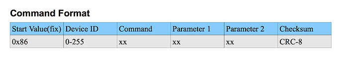

I have the RS232 shield ( this one ) connected to arduino UNO and I am trying to send simple commands to a player via RS232 cable.
After several tries and many copy/paste from this forum I came to this situation:
I only get a sequence of numbers from the serial monitor but nothing happens on the player
I am sure the HEX sequence of the command is correct (the format from the manual is attached) but still I don't get any result.
What's my mistake?

Actually your answer saved me. Since I got no errors I supposed the method was correct. To keep it simple I skipped the external function and it worked.
The code to send the array of hex with the mentioned shield is
