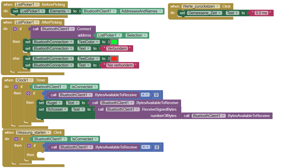

I have a project where I want to measure the time an object needs to fall from a given height. That part is already done by adding a display to my Arduino UNO and giving out the measurments this way. But now I want to view my measurnents by sending them to my smartphone via the HC-05. This is what I already managed to do:
Arduino Sketch:

MIT App Inventor2:
in attachment
My problem now is that I dont know how I can read out the time (in ms) and send it to the Smartphone. Dou you have any advise for me?
