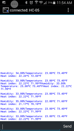

I just started using the Arduino Uno and have done a couple easy and small projects with the HC-05 Bluetooth module (ZS-040).
The basic functionality for getting information from the HC-05 BT Module to your smartphone comes from different smartphone apps that essentially turn your smartphone into a Bluetooth Terminal. Then, your Arduino code directs the information to the "Serial" connection, which is really just the Bluetooth terminal.
In the attached example (which I documented pretty well), I have a Temperature and Humidity sensor sending information to my smartphone via the HC-05 BT module.

Pearllpy:
I found out that the bluetooth HC-05 is a cheap option but i was wondering if it is possible to transfer data from this arduino board to an app on the phone using this bluetooth?
If the phone is an Android device then, yes the HC-05 will work fine.
Pearllpy:
How can I display the data on the phone?
You need an app on the phone to display the received data.
It looks like neogoeo has an example of how to do this.
