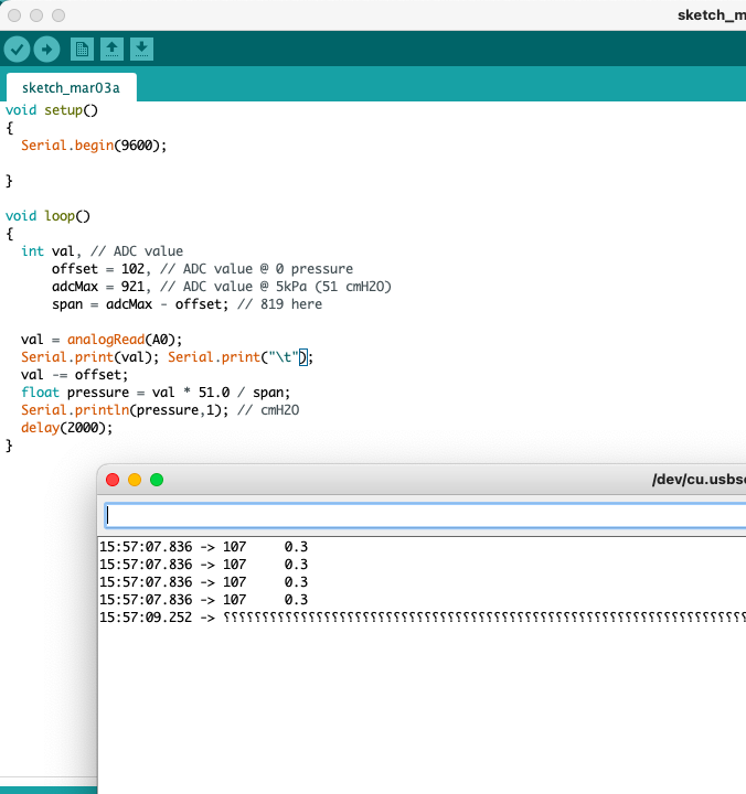

5kPa is about 51 cmH2O, see if this works. Watch the ADC value and set variable "offset" correctly if it's not 102 @ 0 pressure.
  int val, // ADC value
      offset = 102, // ADC value @ 0 pressure
      adcMax = 921, // ADC value @ 5kPa (51 cmH2O)
      span = adcMax - offset; // 819 here
  val = analogRead(A0);
  Serial.print(val); Serial.print("\t");
  val -= offset;
  float pressure = val * 51.0 / span;
  Serial.println(pressure,1); // cmH2O
  delay(2000);

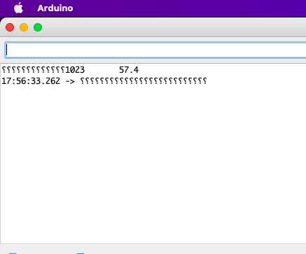

This is the output i get

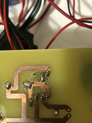

Can you please post some images of your project?
The problem you have looks more like a loose connection rather than code problem.

Did you change the "offset" variable to 107? What do you read with 15 cmH2O applied to the sensor?

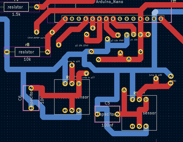

this is the code im running on my Arduino for my ventilator currently. NOTE: not my code

I have done what you suggested:
Code im using:
  val -= offset;
  delay(2000);
When A0 pin connected to GND:
Screen Shot 2023-05-31 at 5.55.45 pm
At 3.3v:
Screen Shot 2023-05-31 at 5.53.55 pm
At 5V:
Screen Shot 2023-05-31 at 5.56.35 pm
Thanks for the reply.
Can you please run this code and do the process in post #38 again;
int RawVal = 0;
int PressPin = A0;
  RawVal = analogRead(A0);
  Serial.print("RawVal \t");
  Serial.println(RawVal);
  delay(2000);
